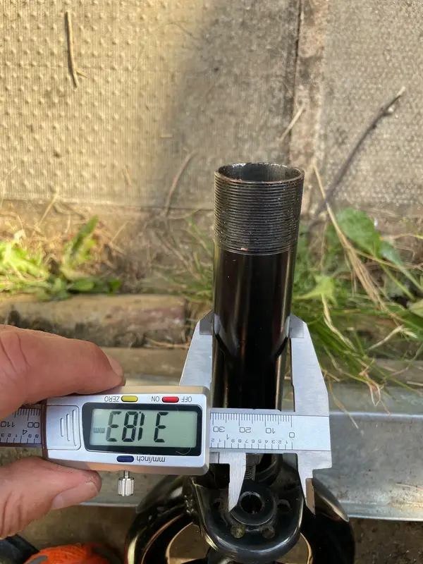

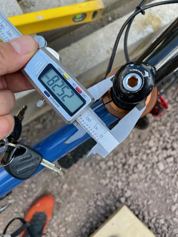

Tried it and it definitely didn't fit. Hopefully these pics explain it. Please do let me know if I'm referring to stuff by the wrong name though. I haven't worked on 90s bikes since, er, the 90s :D IMG_7573.jpeg IMG_7576.jpeg IMG_7575.jpeg IMG_7574.jpeg
If the quill is 25.28mm ( close to 25.4mm or 1") then it's a 1 1/8th headset. It's counterintuitive.
To fit the headset the quill has to be smaller.
E.g. 22.2mm quill is for 1" headset..
28.6mm quill is 1 1/4"
28.6mm quill is 1 1/4"t
