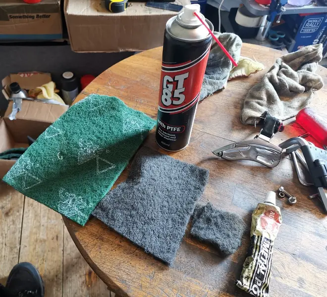

This is what i use, GT85 then green scotch cloth then black then brown and finally autosol.
GT85 to remove the dirt, green takes off the oxidation but leaves scratches. Black then starts removing the scratches and giving a shine. Then the very fine brown cloth takes most remaining scratches out and gives a really nice shine, finish off by using the autosol. Takes time and patience but worth the effort. You can do that method on pretty much most of Shimanos parts Deore MT60/MT 62/650/Deore XT M730/M732/M735 etc and you get the same results.

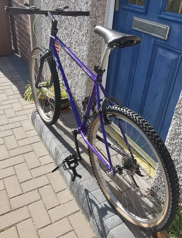

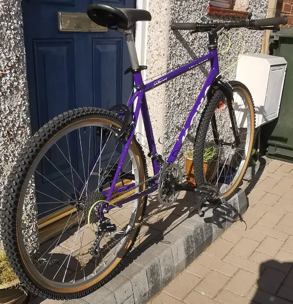

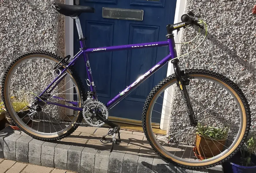

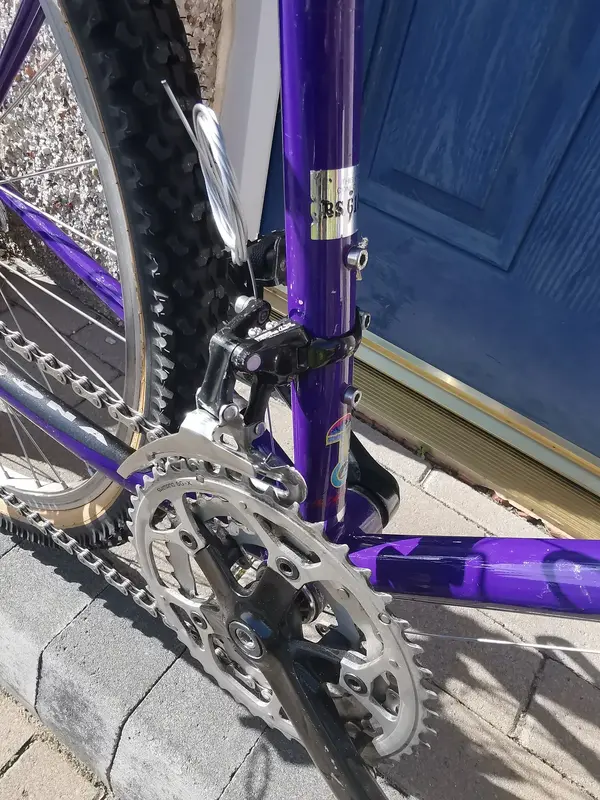

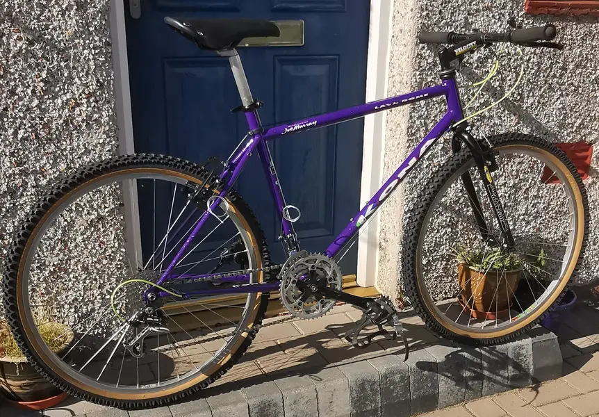

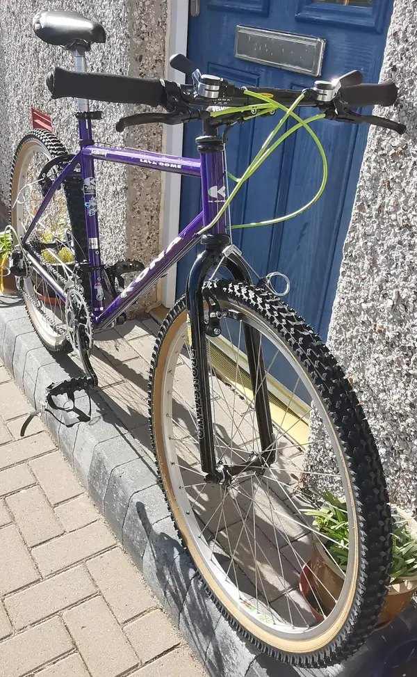

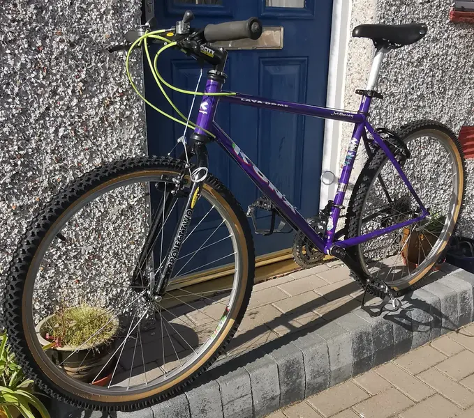

Nearly there, the mech arrived today so it's cabled up and i found a brand new set of Wolbers buried in the cave, as you do 🤣
Just waiting on a new seatpost to arrive and to clean the wheels and cassette then set it all up for a test ride.
Happy days 😊

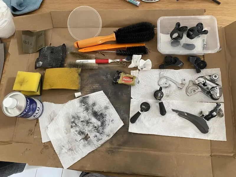

I’ve been using your method. Working well so far.
I wish there was a short cut 😆. It’s amazing how much grime builds up on the old components. Multiple passes with autosol and still there are black streaks coming out.
I am trying belgom alu as a final coat as it contains wax, apparently it will protect the shine a bit longer. Let’s see.
