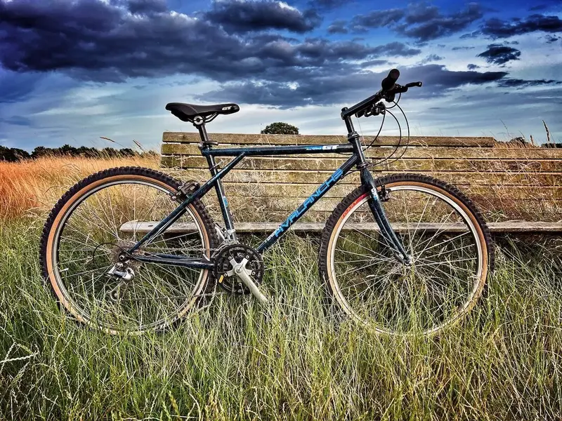

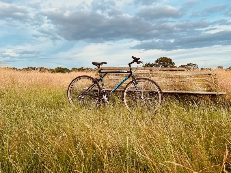

I'm pretty much using this bike every day at the moment - so it's going to be my rider for the summer. I managed to pick up some Shimano XT NOS hubs so will rebuild the wheels over the winter, I have a few bolts and nuts to replace with newer, less corroded ones. So for now, it's kinda done.

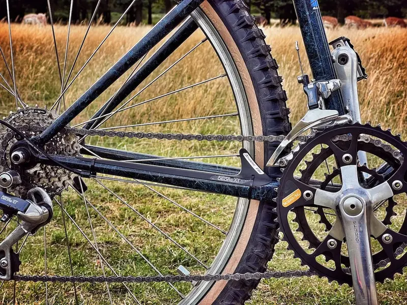

I got a front puncture last week and whilst I loved the period accuracy of the Ritchey Megabite tyres, the were certainly showing their age (and made a noise like an angry hornet when riding on tarmac!!) So I took the opportunity to replace them with a Smoke and A Dart. It has transformed the ride...as you would expect. I also managed to find a NOS Shimano Sharkfin Chain deflector/protector which I have fitted

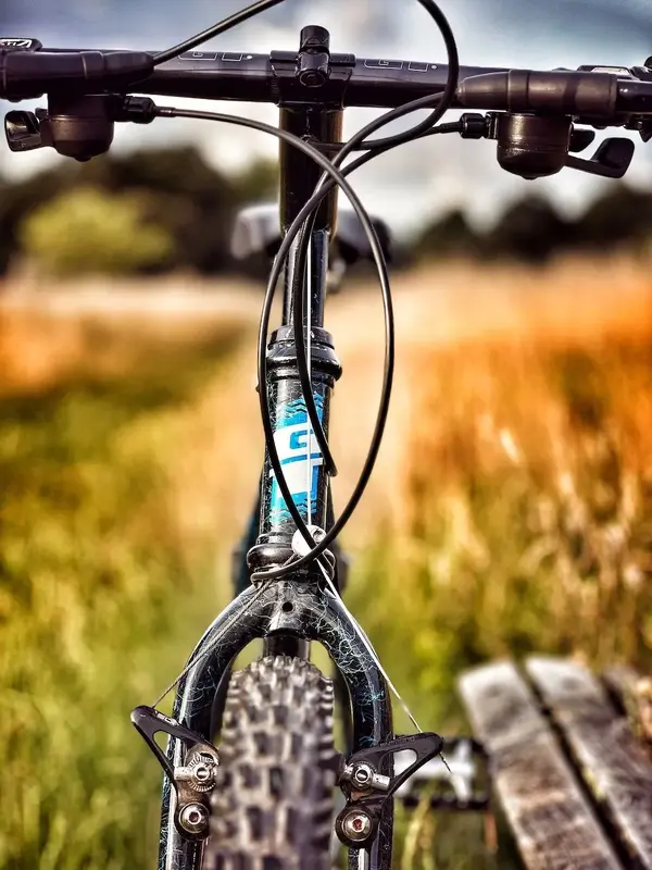

Though you really need to lower that straddle cable on the front brake as the cable outers are messing with the brake alignment. And also messing with my bikey senses😂
Haha, yeah, i only noticed it when I posted the photo last night and it's been bugging me all day :LOL:. Will fix it this evening after work. Brakes aren't symmetrical either..... Some minor adjustments on the back brake too...I consider this the 'tuning up' phase... helps with my OCD!
🤣 🤣 🤣 I was going to comment on that, but resisted. But with these style hangers you are stuck with the length of they are because the one side has a nipple either end so is fixed in length. It should be visible on the back of the hanger... Otherwise switch to a more "traditional" hanger like on the U brake which means you can lower it. However...
The outer casing on your front brake looks too long and also your front QR is on the RHS, instead of the LHS...
