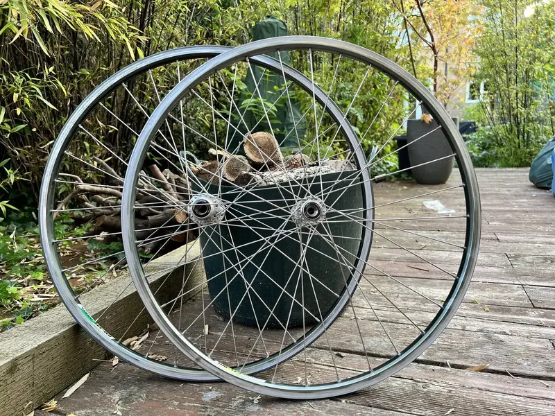

Mini update. Finally got the back axle out after a lot of WD40 and patience! IMG_1883.jpeg IMG_1882.jpeg
At least now I can clean the wheels up properly. Rims look in surprisingly good shape otherwise some corrosion in hubs where the bearings had rusted, but we’ll see how it runs with new axles, bearings and ceramic grease before I replace. (I’ve seen worse 😄)

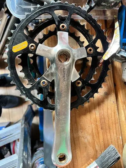

Elsewhere, components to rescue…. Or perhaps replace… waiting on decals at the moment before clear coating the frame. Bit apprehensive about messing that up, but the frame has been, if anything, over prepped… so fingers crossed. IMG_1775.jpeg
