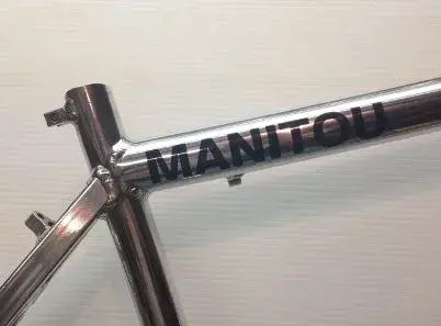

Finished polishing, and applied decal, as close to the original as possible. Thanks Gil_M! When I was researching this restore, I couldn't believe how many different styles of decals Bradbury used between 1987 and 1990. I've seen at least 4 different fonts used, and various degrees of decal coverage. My bike came with ONE decal! Right where I just plastered this one on tonight. Gil made more for me to use, but I'm hesitant to bedazzle recklessly.

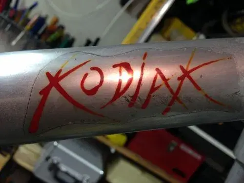

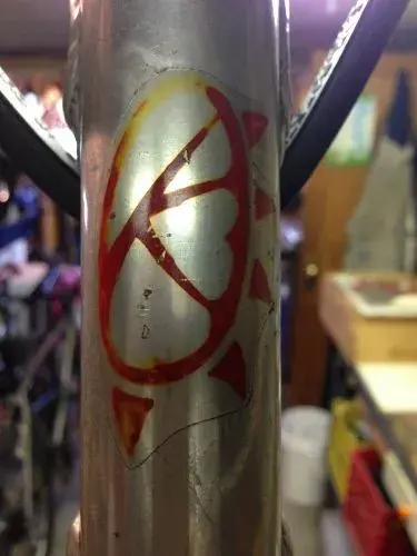

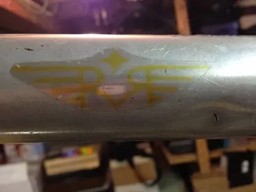

I have the decals I applied in 1988 still on the frame, and I think I have to keep them:
Kodiak Bikes was my bike design company (in my mind). The 'Kodiak' decal was supposed to look like grizzly bear scratches, and the head tube badge like a bear paw...
Raven Racing was my race team (i.e. the guys I hung out and went on rides with)
