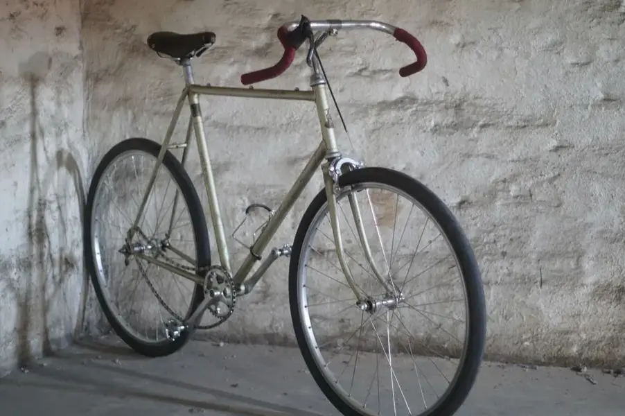

It all began with my 1970s Gazelle Sprinter I found abandoned on the street in December 2020. Despite it was to large for me, I used to ride it quite often during last that year, till a back injury kept my arm numb for months and me basically off any bike activities.
Since, I was drawn to the idea of a fixed gear dirt tourer. Of course the American influence of a certain Ronnie Romance didn't help and neither did the digital archive of the RSF. But the Gazelle was not only to large, its already very low BB prevented any modification like a 650b conversion. So I began to search for a successorr. With a very limited budget due to a sudden unemployment, I couldn't go for any readily avaiable 650b builds I found, but eventually a nice looking and reasonable priced Raleigh Record Ace showed up in my neighborhood ...
Of course the heritage of the RRA with Booty and the other Raleigh riders gave me some inspiration and although the 1980s Aces weren't any longer produced as track bikes, I at least hope that they manufactured my frame in Nottingham with some of its history in mind.
However, the frameset was quickly build and ridden on some shorter trips. It was beginning of July when I took her out to a first longer off road tour.

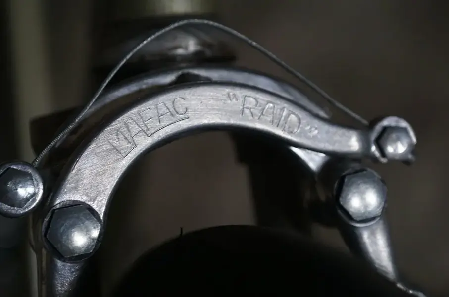

After this I decided not only to put all other bike projects a side and concentrate soley on the Raleigh, I decided as well it was time for a 650b conversion. Surprisingly frame and fork can handle 42mm tires and a new set of Mafac Raid brakes arrived just a few days ago to kick off the build.

Well, after gettin a 650b wheelset and a fixed hub, which I could easily convert to 126mm I build a new rear wheel and failed - actually not me but the rim... A massive radial turnout couldn't be trued and given the tight clearance in the rear, I decided to go with my 700c wheels.

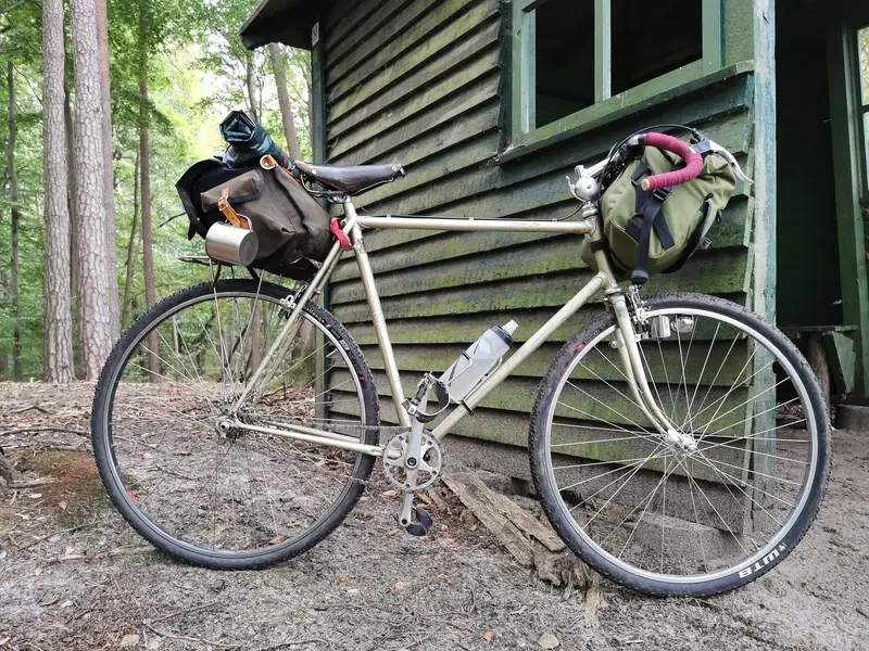

I took the RRA to a 200km trip over night into the northern woods of Brandenburg.
I realized that the toptube is actually more thann an inch higher (34") than my inseam (32.5") which made it bit scary in the woods and more so difficult to get on the bike. One could argue the frame might be to big for me...
But looking through the Rough Stuff Fellowship book, I saw a lot of bikes with only a tiny piece of seatpost visible. What you think - gettin a smaller frame or keepin this one? I like how it rides, the patina and the long headtube...
