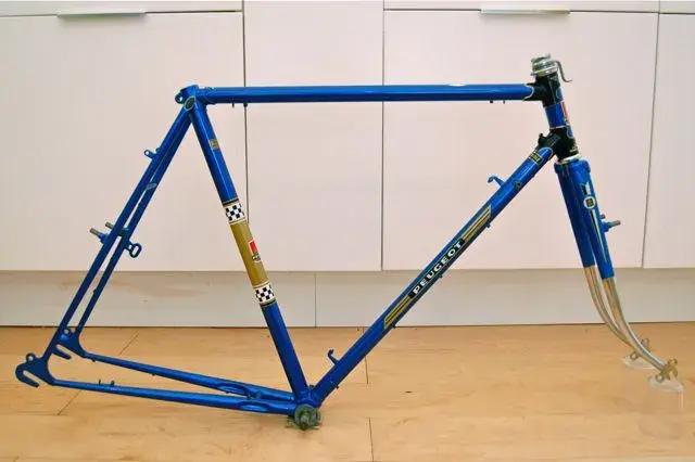

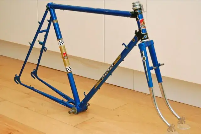

The colour is blue clear on top of silver and it is very close to Peugeot original blue metallic.
This is not mine but found it on the net..

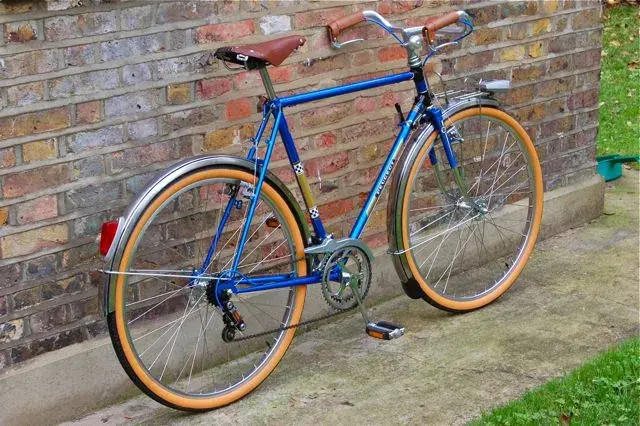

And here is the finished bike.
I ditched the rear rack as it is a bit too big for my liking.
I attached home made mud frap at the end of the front mudguard for practical reason as well as cosmetic reason - longer front guard make it look much elegant in my view.
Also I relocate the front light about 20mm toward the front edge of the guard for cosmetic reason, too.

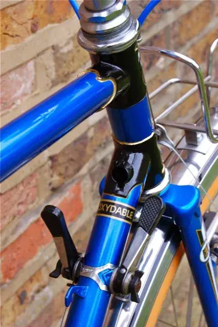

The handle bar is Grand Bois promnade made by Nitto. It goes well with Dia Compe opposite levers.
The stem is replaced by ITM 90mm to match with the bar. It is BSA 22.2mm insert diameter. To insert 22.0mm French fork steer, I sanded down 0.2mm by hand.
The cables are matching coloured Jagwire outer and all the inner cables are stainless steel to survive wet winter weather.
The saddle is old old Brooks B15 Champion Standard (assuming non original) and I painted it with leather paint to compliment the bar grips.
But it started rubbing off already :roll: it may be replaced with proper brown saddle soon.

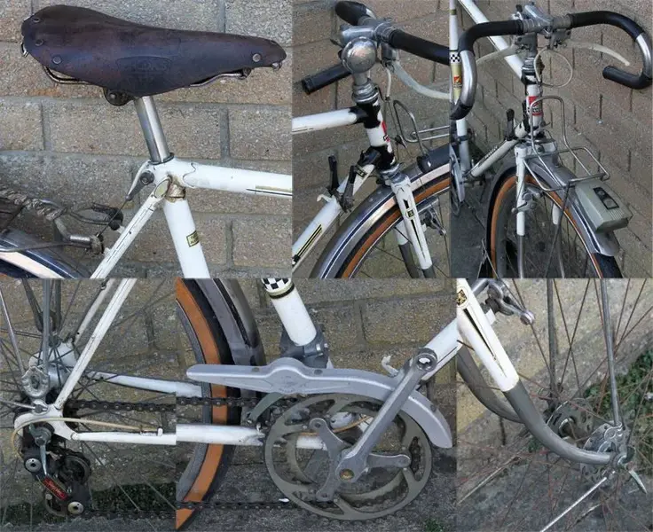

On the right pic, there is a big hole on the lower rug and this is where steering lock should go in.
I need to source it as well as aluminium flap which will cover the hole.

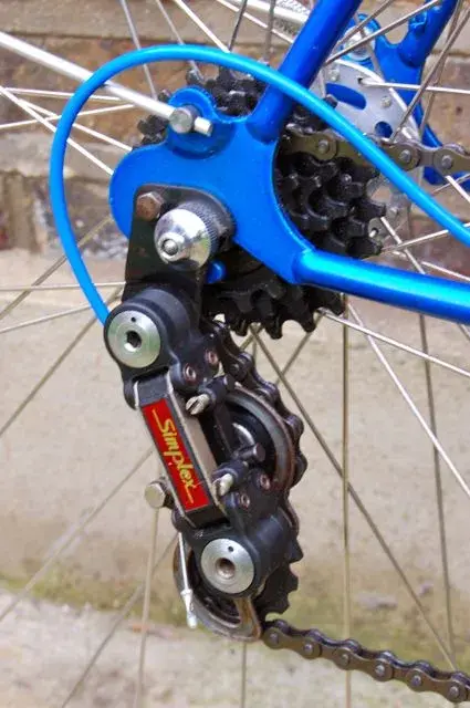

The rear Simplex is original - the cage has lost its chrome due to the heavy usage but it still shift well after serious cleaning and re-greasing.
Free wheel is Atom 5 speed 14-23 NOS, same as original, and the chain is brand new KMC Z30.
It supposed to work with 5 and 6 speed but unfortunately it skates (not sit in the gear) occasionally when shifting the rear with front large ring. :evil:
I don't know why - may be the chain pins are not wide enough or my shifting skill is not matured, yet?

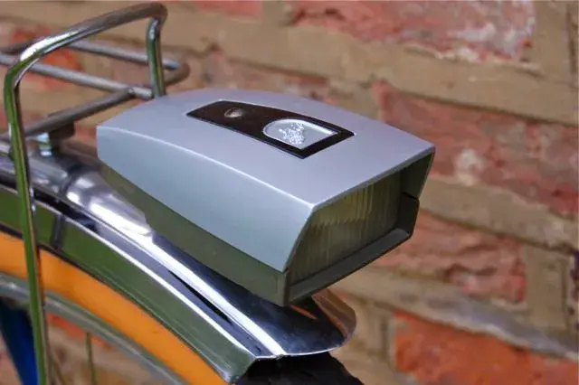

This front light cover suffered from big crack and it needed lots of epoxy glue and fillers.
Original was shiny chrome but I compromised with Humbrol silver paint which came up as grey when I spray clear on top... 🤦

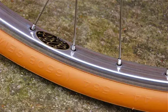

When I have been to Japan for family holiday, I didn't forget to buy the pair of Grand Bois alloy rims!
Took them as check in luggage and they survived fine :D
Hubs are Normandy used ones with quick release and I build the wheel with #14 stainless steel plain spokes.
This balloon Michelin tyre 650-44B is very cheap @ £10 but rolls well and most of all, very comfy!
I have done about 200 miles so far and I love it!
