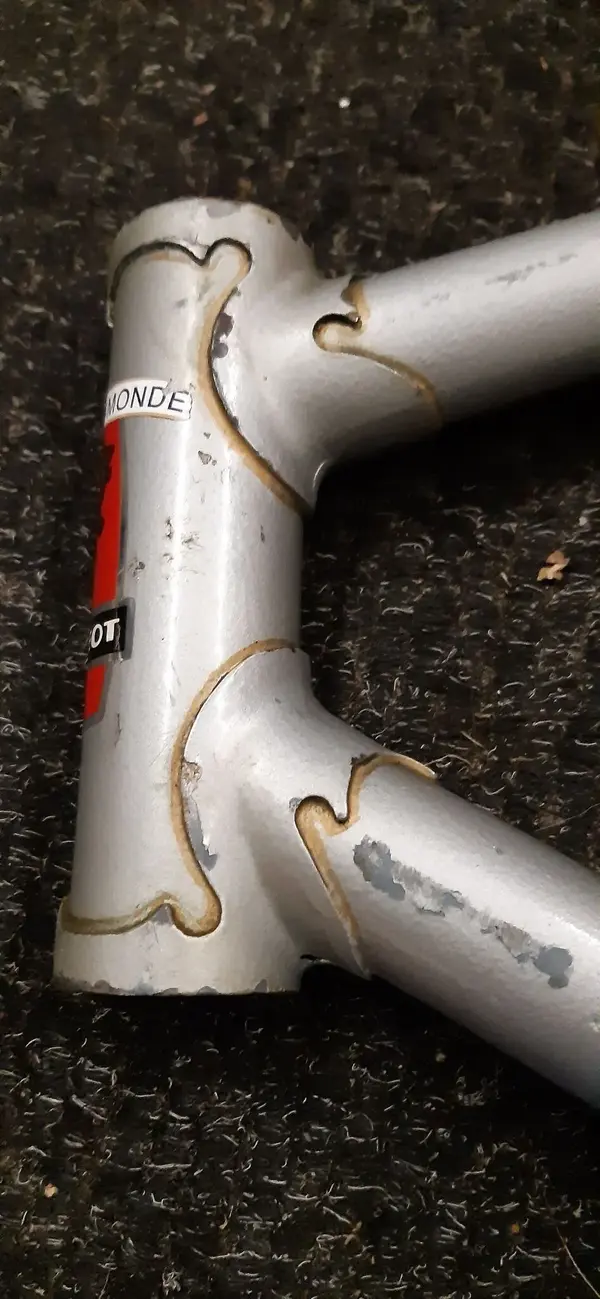

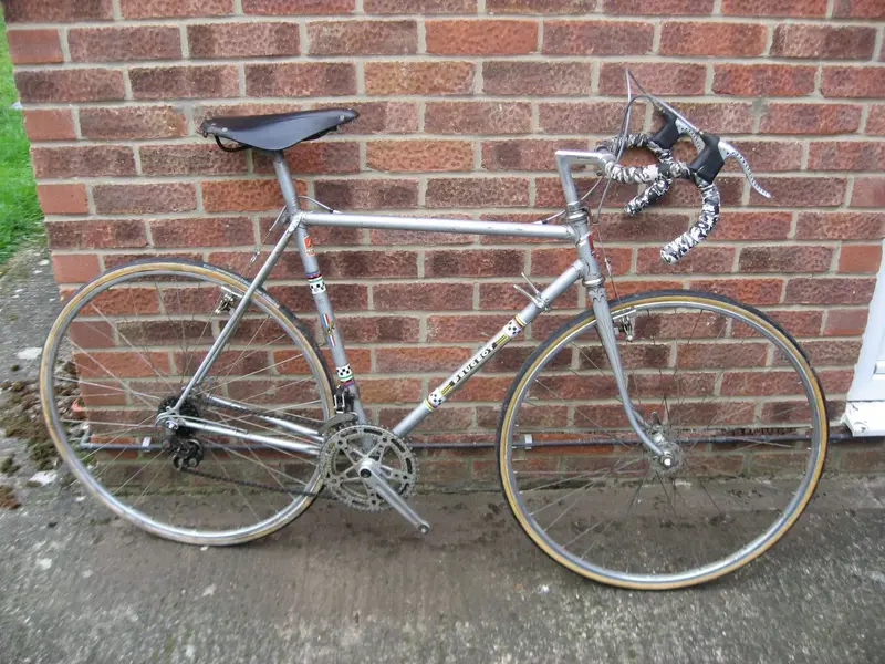

I'm about to start work on the frame of a bike I bought a few years ago and I'd like to know exactly what it is before knowing how much to commit. I have searched all over the web and can't find a bike quite like this one. I believe it is a Peugeot but beyond that......
I cannot find a frame number anywhere, all of the paint isn't off yet so it may still be hidden. The frame is stamped BUTTED, the dropouts are, I think, Simplex. The rear brake cable is routed inside the crossbar. The brakes are Mafac cantilevers, Criterium I think. The frame weighs bang on 2kg.
The forks are stamped VITUS and weigh 800g.
There is no evidence of chrome on the frame or forks.
Stronglight head bearings and crank set.
Simplex front and rear mechs.
I know things get changed of the years so it's hard to be sure of anything but cantilever brakes and the rear brake cable inside the cross bar must point to something?

Closest I can see to yours is maybe this from 1978, although could be a year or two earlier. As you say, maybe one or two things may have been changed or replaced over the years such as the rear brake cable route or the forks.
Thank you rikster. Interesting brochure, I looked through it carefully but all of the brakes seem to be 'tirage central', which google translates to 'central draw'. I assume this means conventional centre pull rather than cantilever. It's the cantilever bit that's throwing me, I can't find any reference to cantilever brakes anywhere?

This is a Peugeot, a PY model and probably a Custom order from Peugeots equivalent of Raleigh SBDU ( Atelier Prestige ) I've had 70's Peugeots with such features. Peugeot made lots of VITUS steel most latterly 980 tubing ( for example the Mont Cenis model in the mid 80's ). I have a later Pro 10 on ebay at the moment with the same top tube internal brake cable routing.
