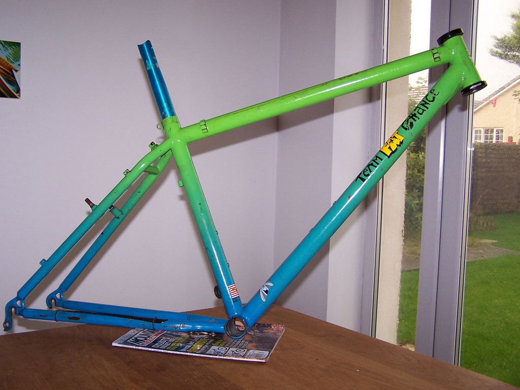

Late last year an opportunity arose to answer that question. Kaiser had a very tired Yo Eddy frame that had suffered the usual rusty seat tube and had paint that even a mother couldn't love. It was probably beyond ecconomical repair so an ideal candidate for a little tinkering. It was also a small frame- ideal for what I wanted with lots of standover.
The frame was media blasted to reveal 5 small holes in the bottom of the seat tube. It was then shipped of to Kevin Winter in Durham for repair and the addition of a disc mount and cable guides. Meanwhile I got on with deciding what parts to use.

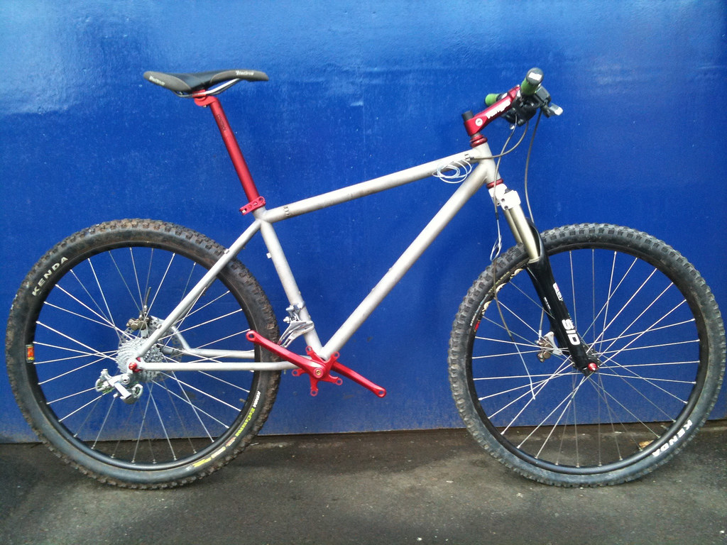

I tried various different fork lengths to check geometry. The Yo Eddy was always a steep angled race bike with a relatively low bottom bracket. This being a 94 frame and already suspension corrected I discovered that fitting a 100mm fork would give the same geometry as my Cotic Soul- i bike I have done many a mile on over the last 18 months. Before sending the frame away i quickly built it up with a 100mm SID and tried it out. It was spot on, still sharp enough in the tight bits and beautifully balanced in the fast flowing bits- Game on!

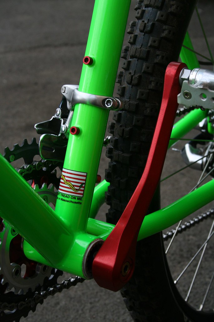

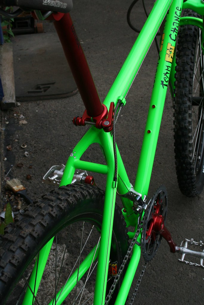

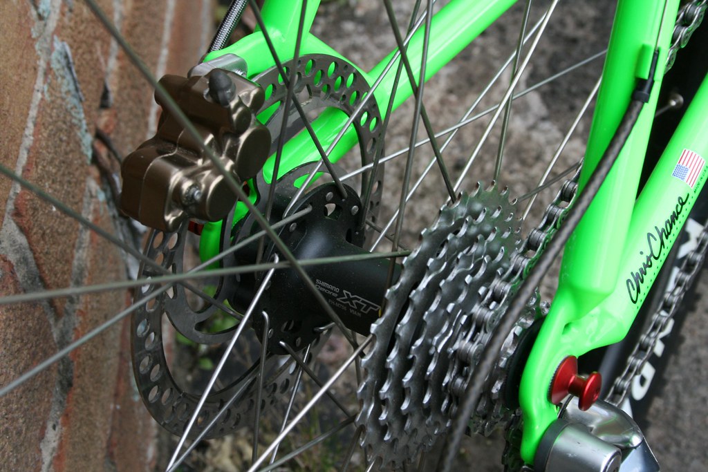

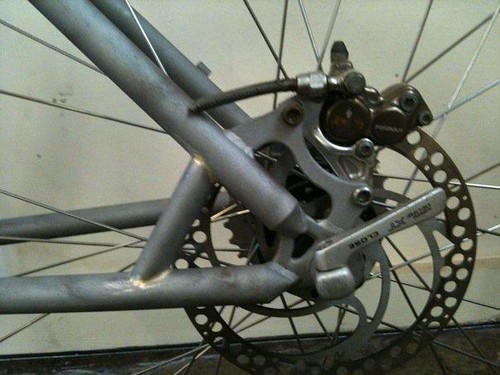

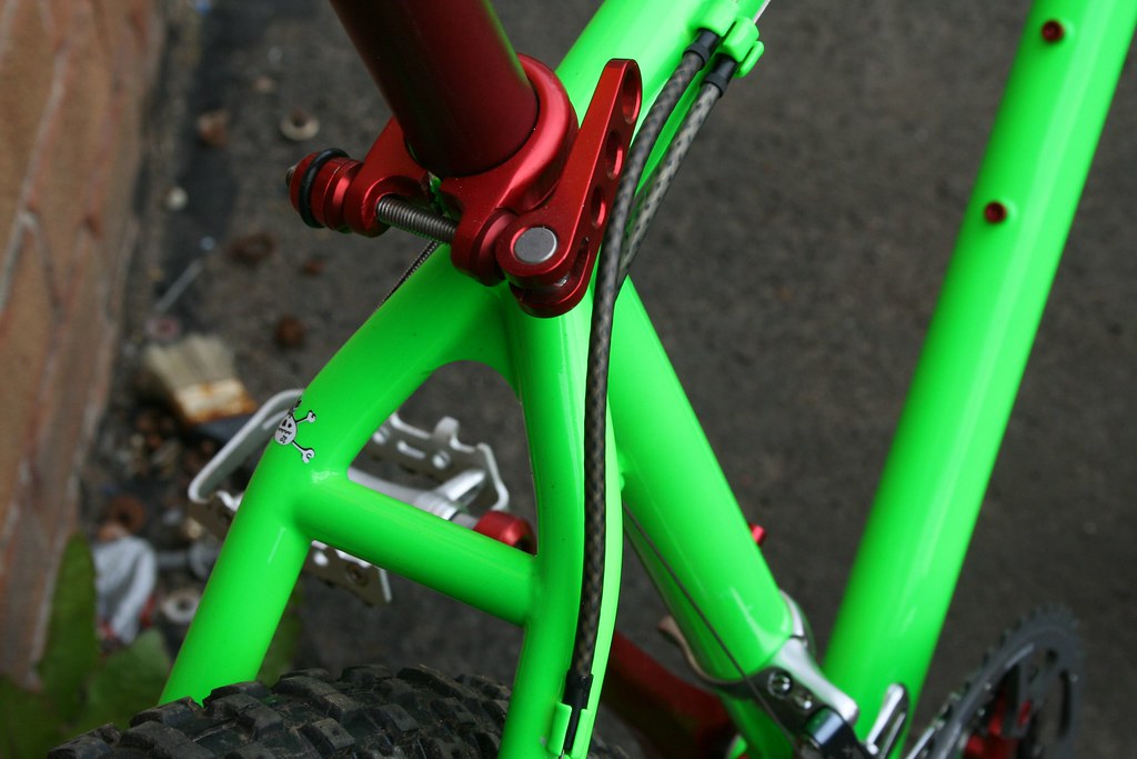

The frame was returned a few weeks later. Kev had decided that the seat tube wasn't bad enough to justify a full replacement. He drilled out the holes and made small 5mm plugs and brazed them in. The repair was invisible. He added a disc mount and brace as well as the cable guides and removed the canti bosses and cable bridge. Absolutely top notch work, the frame came back ready for paint apart from the original top tube guides that now needed to lose a notch.
A quick build to make sure everything fitted and its off for paint.

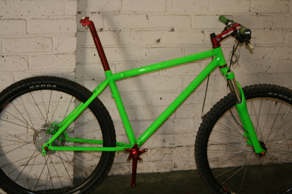

I then powder coated the frame in white before laying on 12 coats of flouro followed by 4 or 5 coats of clear laquer. Unfortunately it doesnt photograph too well- it really is eye burningly bright!

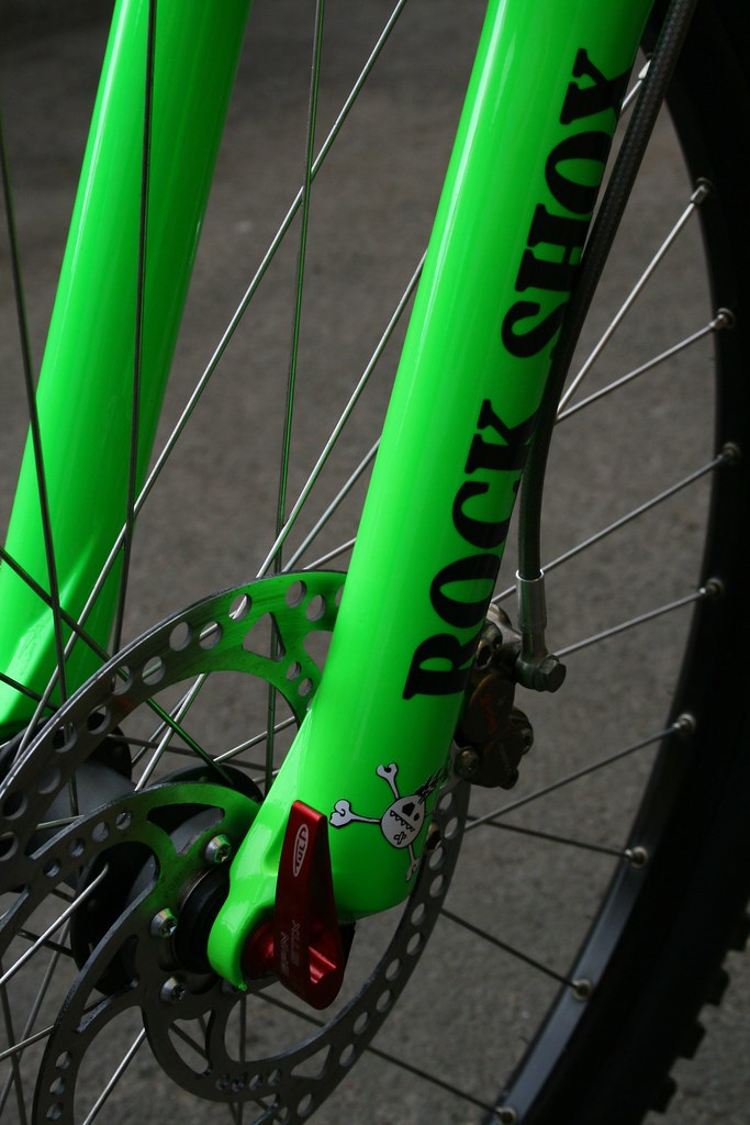

The forks (2001 SID 100 Hydra Air) were stripped and rebuilt. I had to cut off the pressed in crown as it was 1 1/8th and fitted a late 90's Judy DH threadless 1" steerer and crown. The legs were disc and canti- I hate unused canti mounts so these were carefully cut away and smoothed into the legs for a cleaner look. These were then colour coded and Gil did a set of Neo Retro RockShox RS1 decals and over sized Eddy decals which I think look a treat.
Next job was to gather the parts. I chose Formula Racing 4 pots for the brakes. I've always liked Formula's and run them on my modern bikes. These will be kitted out with Goodridge Hoses and Sintered pads later this week. I wanted strong but light wheels that I could run tubeless. A pair of Sun Ringle Wheels I had in the shed would do the trick although I now have some red Hope Pro hubs to build up when I get the time. The rims were de stickered (front still to do) and I fitted my favourite tyre combo- tubeless Kenda Blue Groove up front and an Excavator on the back.

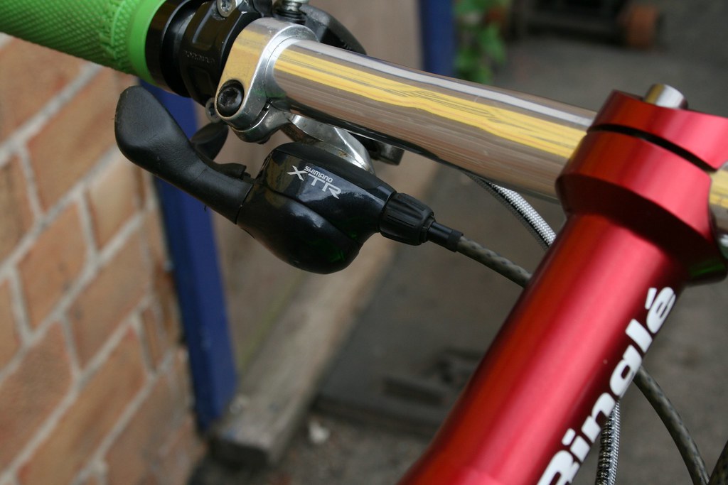

So that was the modern bits sorted. As I said, I wanted that period look. that meant lots of nice anno. I have always loved the Guvnors Sublime Grellow Yo with all the red bling and I decided to use that as my starting point. I collected a few tasty parts- a NOS Ringle stem from Sith, a NOS Control Tech post from Kaiser, a set of silver Grafton cranks and shipped them all off to Mansfield Anodisers. A week later I had a pile of red bling ready to fit. I added to this a few red touches- bolts, QR's, and a new Chris King Sotto Voce headset.

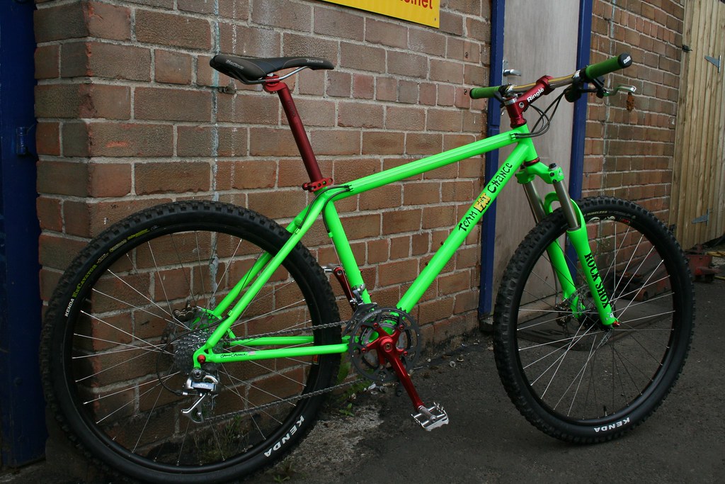

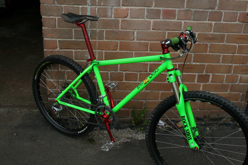

Busy workload meant that it took about a month to build it up, but today it is almost done. I still need a few small items- hose connectors, a chainring bolt (gawd knows how i managed to lose one). These should be here over the next few days and I hope to use the bike on Friday for the Big Dirty Weekender recce.

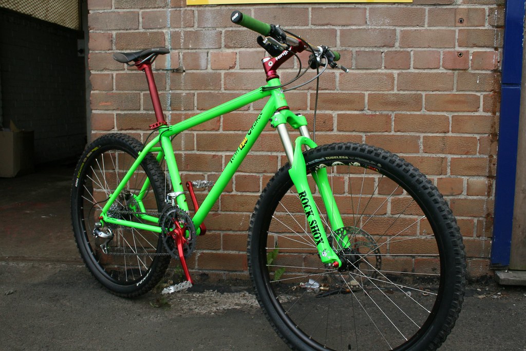

So then. Not one for the purists I guess, but a very capable machine that has the best of both worlds- the craftsmanship and beauty of the 90's and the handling of a modern bike. I will let you know how i get on with in.

Stem: Ringle

Shifters: Shimano Deore XTR M900 on later polished XT mounts

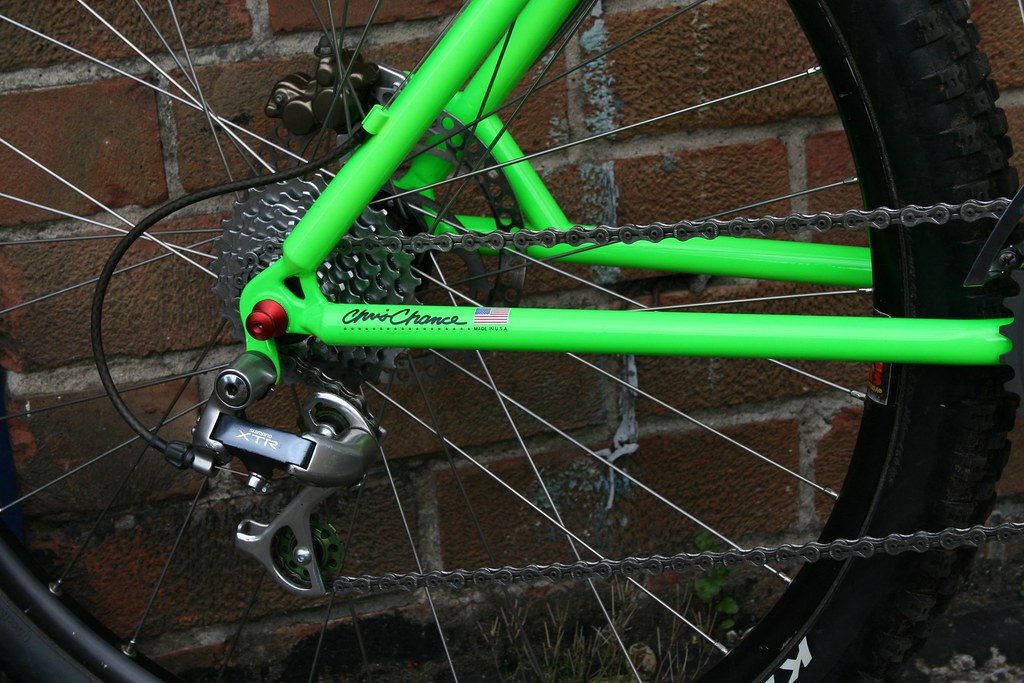

Front Derailleur: Shimano Deore XTR M900
Rear Derailleur: Shimano Deore XTR M900
Derailleur Cables: Transfil Flying Snake Kevlar
Cassette: SRAM 8 speed

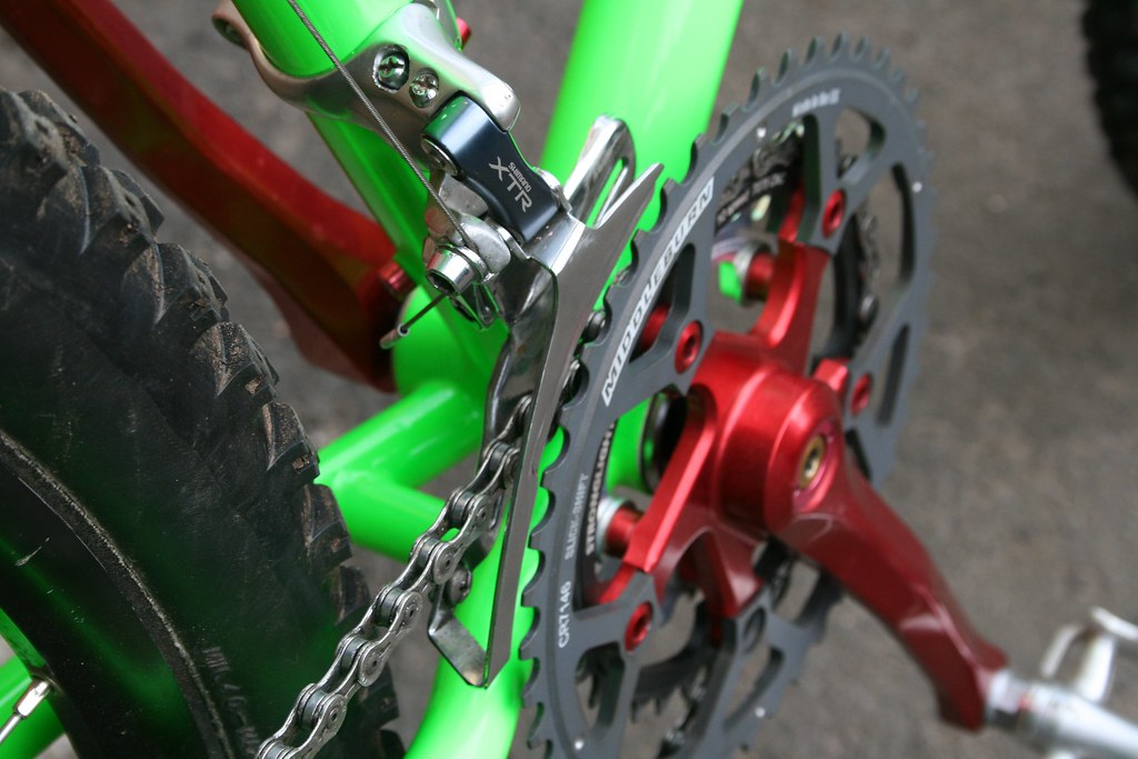

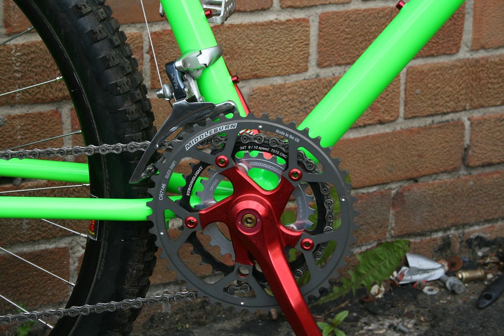

Cranks: Grafton Speedstix II
Crank Bolts: Middleburn Self Extracting
Chainrings: Middleburn
Chainring bolts: Middleburn

Seatpost Binder: Annodized Fat clamp with Ringle Ti Stix binder

Clean lines now the canti mounts are gone. really shows off the beauty of Chris Chance's frames.
