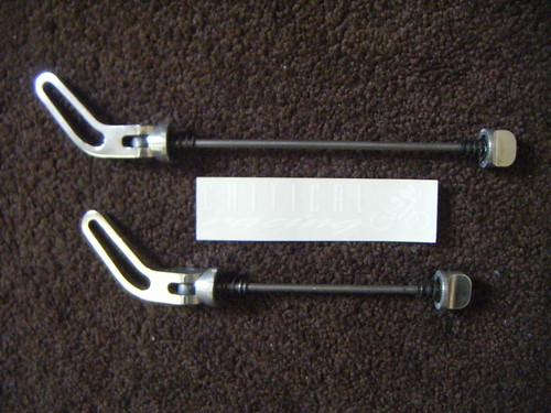

Instead ive been lucky to find a pair of used 'critical racing' skewers in silver, they came off ebay, fitted to a pair of campag wheels, they where battered & bruised, but after a bit of sanding and a good ammount of autosol, they have come out ok.., these go very nicely with the campag icarus canties, and go well with yeti's of this age, being one of the sponsors back in the day..
