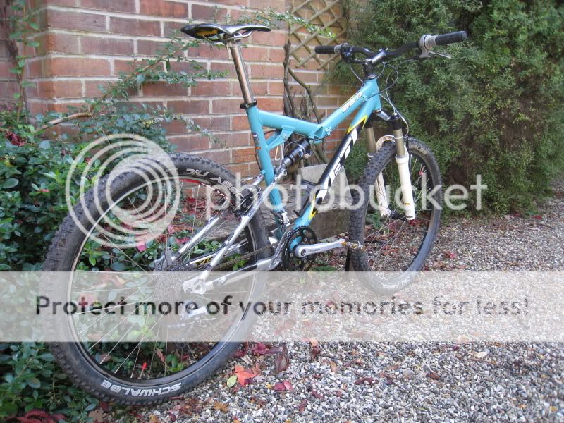

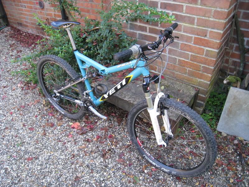

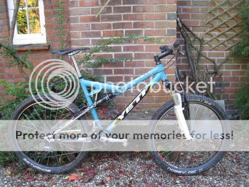

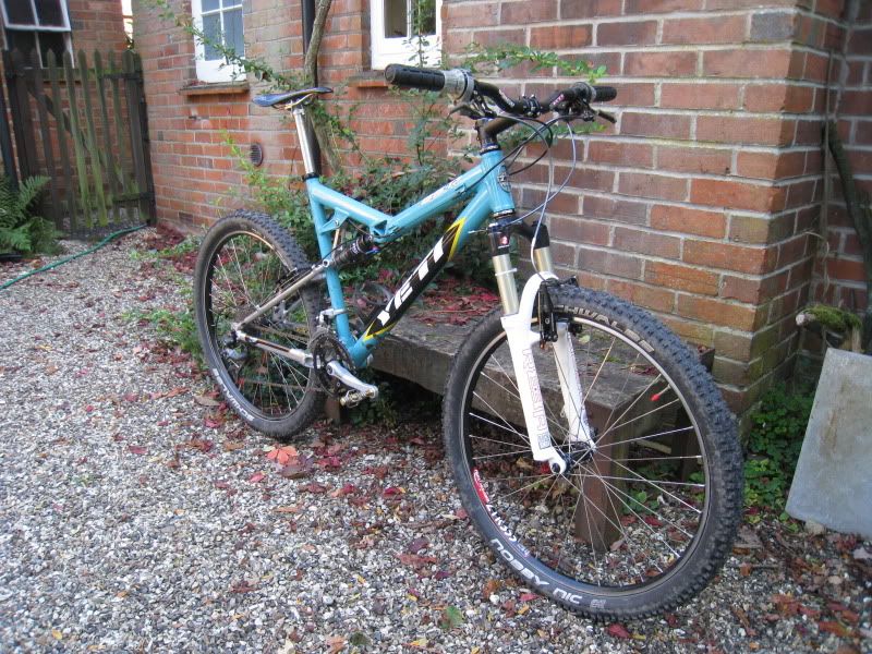

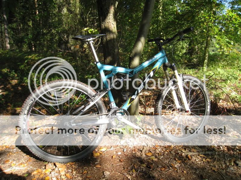

Did a bit of work on it over the weekend:

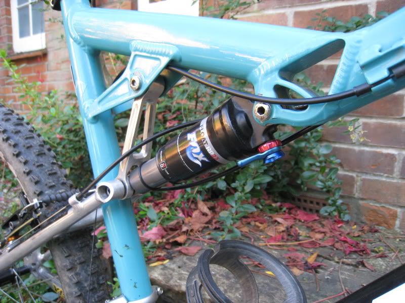

Managed to get the RP23 rear shock fitted instead of the 5th Element after receiving the fitting kit and new bushes for the front mount.
Swapped the SIDs for my Rebas World Cups.
Swapped the Ritchey WCS Stem for a Syntace one and the Monkeylite bars for RaceFace carbon ones; they're a bit wider and slightly less back sweep.
Swapped the USE Alien 'post for a Syncros Ti one as it's in-line rather than lay-back ;)
The RaceFace chainset was swapped for a Middleburn RS8 Duo which the Yeti will share with my King Kahuna :)
The Dura-Ace mech was swapped for an M952. Oh, and fitted a Sram 9spd 'attack' gripshift as the right hand shifter instead of the x-ray 8spd. Oh yeah, also M953 9spd cassette ;)
Took it out for a little 'pootle' today and seems to be working quite nicely. Rear shock will probably need a service though :roll:
Cleaned, post-ride....
I do wish (some) dog owners would be more responsible with their mutts produce :roll: :evil:
Spec now...
Frame: ..........2003 Yeti ASR-SL with Fox Float RP23
Fork: ............Reba World Cup
Headset: .......King
Stem: ...........Syntace F99 with Ti bolts
Handlebar: ....RaceFace Next XC Carbon Riser
Grips: ...........OGK
Barends: NA
Brakes: ..........Extralite
Brake Pads: ....Extralite
Brake Cables: .XTR
Brake Levers: .Extralite
Shifters: .............Gripshift: X-Ray (front) Attack (rear)
Front Derailleur:.. XT
Rear Derailleur: ..XTR M952
Cables: ..............Shimano
Cassette: ...........M953 12-34
Chain: ...............KMC 9SL
Cranks: .............Middleburn RS8 Duo
Crank Bolts: ......FSA self-extracting
Chainrings: ........Middleburn 29, 42
Chainring bolts: ..Stainless
Bottom Bracket: .American Classic isis
Pedals: ..............Egg Beater 4Ti
Hub Skewers: ....KCNC
Rims: ...............Stans 355
Hubs: ...............Tune
Nipples: ............Alloy
Spokes: ............Sapim blade
Tyres: ..............Schwalbe Nobby Nic 2.25
Tubes: ..............Bontrager SL
Saddle: .............Selle Italia SLR
Seatpost: ..........Syncros Titanium 27.0
Seatpost Binder:.Yeti
Weight: Approx sub 22lb now.
Possible future developments :)
I've got a white flite saddle on the way which I'll see how it looks, probably fit my Bontrager Mud X tyres when things get muddier and go tubless. Other than that, who knows :? :lol:
