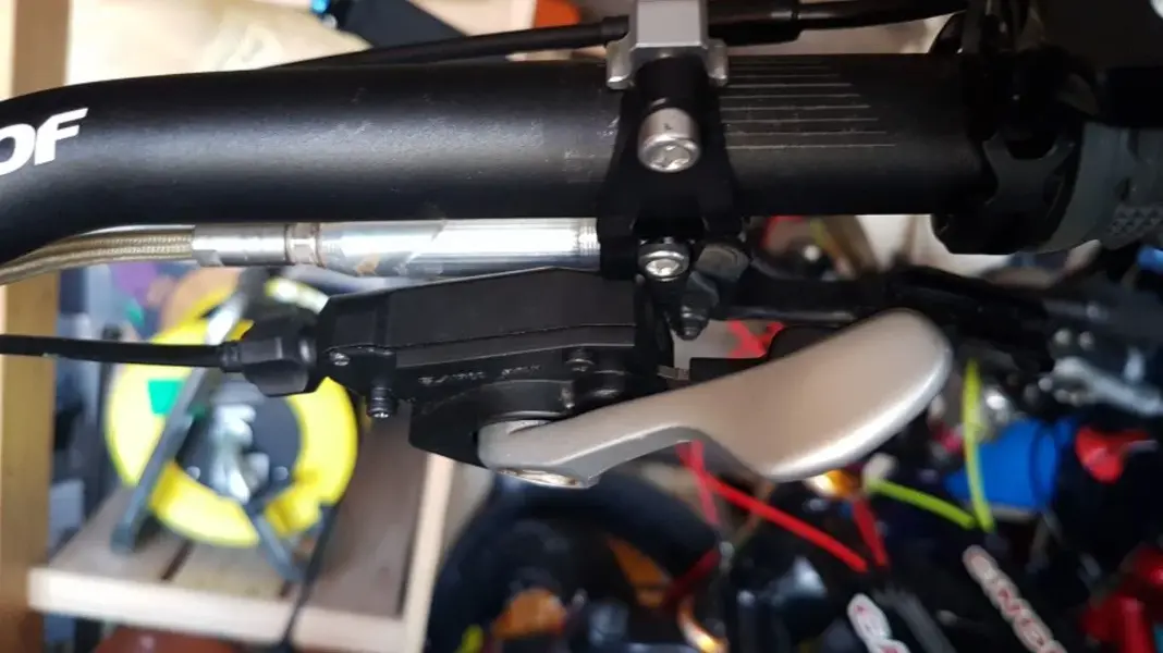

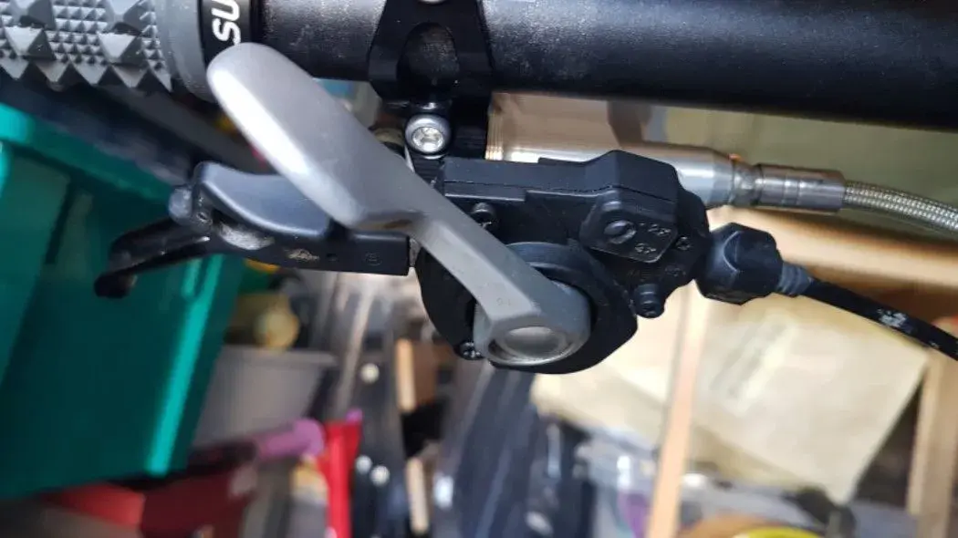

I have done this mod ! using the M780 -spec conversion kit for the shifters and mating the HBSP 264 clamps.....the clamp holes lighn up perfectly and while there is a noticible difference in clamp area (at the front....) it really doesnt make a difference (to me at least) and DOES tidy the bars up a treat !
