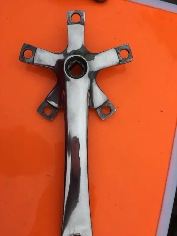

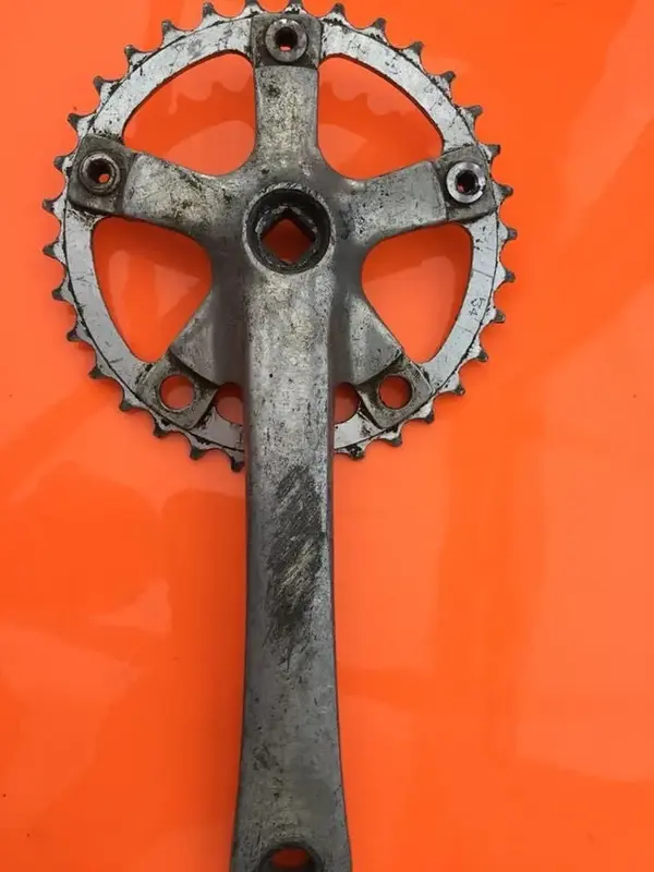

They can be cleaned up even from rough starting
