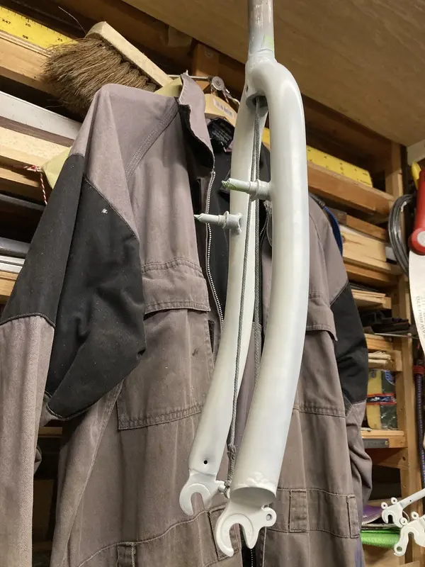

These are the forks that came with the frame, my other older clockwork has the same forks but I know that was built from a frame, by a shop so presumably these are a proprietary fork of the time? Curious on what they are though less important now we have established due to rookie mistake these are correct steerer and will be used!
They're posh forks, looked on by many a skinny fork teen. Surpassed only by the Alu or Pace forks, if that was you bling thing.
Look up 'Tange Big Fork' * (and of course rebrands and similar styles).
Date codes and actual manufacturer are often on the steerer tube.
*Not saying these are but it is the style...

Agh ok, I will look, these I don’t think are as the finish on the welds is less perfect and they feel a little heavier than the ones on my other clockwork, which felt very light… and the weld finish etc was perfect.
So the other bike perhaps Tange which means I learnt something!
Will check out the steerer shortly… thankyou
