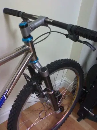

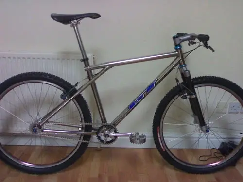

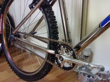

sorry for the delay with the pics - my camera's playing silly buggers at the mo so heres some quick phone ones. hope you guys like it!
i think it'll be a pretty long term project for me - ill just have eyes on the lookout for nice stuff all the time! i would have liked to have tricked her out with the bees knees stuff straight away as i originally planned, but my daft car 'project' has been eating into my fianances lately! :D
one thing i was very chuffed about was getting away without a dangly chain tensioner thingy - the gearing and chain etc matched up perfectly!
anyways, hope you guys enjoy the pics. im looking forward to the first proper ride at the weekend...
