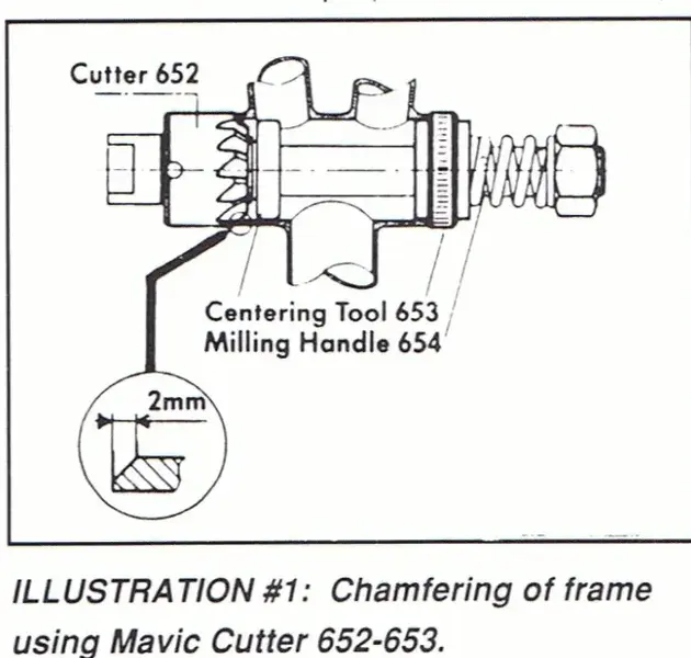

Martin This is some photos of the Mavic cutting Tool 652-653 thats needed to put the chamfer on the frames BB & a diagram of it in place.
Hope this helps
Chris

Thanks Chris.
I 'think' I still have access to the cutter tool.
Looks like I just need the French thread Headset after all. 8)
