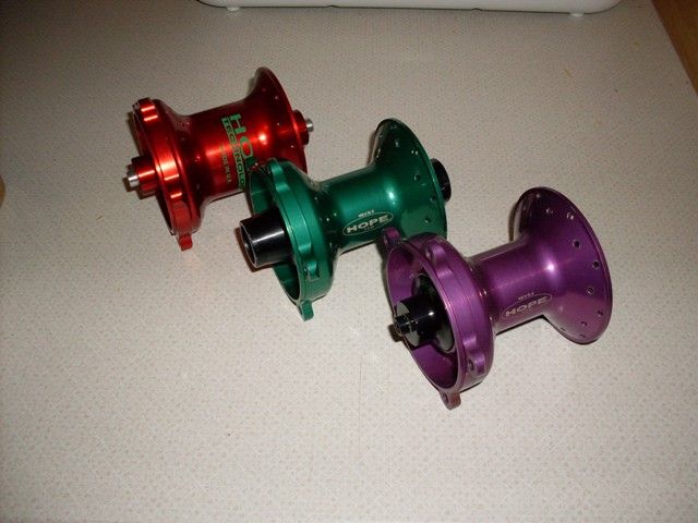

do you have one thats 1 piece ? like the hub I posted at the start ? I used to have 1 piece bulbs in black best ever (http://www.pinkbike.com/photo/9044330/)
I just hate this 2 piece silver disc and spider looks awful and to new for my build
The later Bulbs were one piece with a 6 bolt IS mount. I used to run them on my Big Hit...I think they're better hubs Han the Pro II's that replaced them because they've got bigger bearings.
All of the ones I have at the mo are the old school ones with the disc carriers.
Cheers for all the feedback guys, Now I know what brakes i have, I need to know because of the spider these have on them, If i was to get hope Big Un's would this Rotor just fit straight on with no issues ?
Yes mate, the 5 bolt Hope disc rotors were the same spacing across both the Bulb/XC/Sport spiders and Big Un hubs. Will fit straight on with no issues.
Yup no issues, except a bit of minor filing may be needed...I had to file the the tabs down slightly on my rotors on the Chameleon to get them to fit on the Big Uns.
