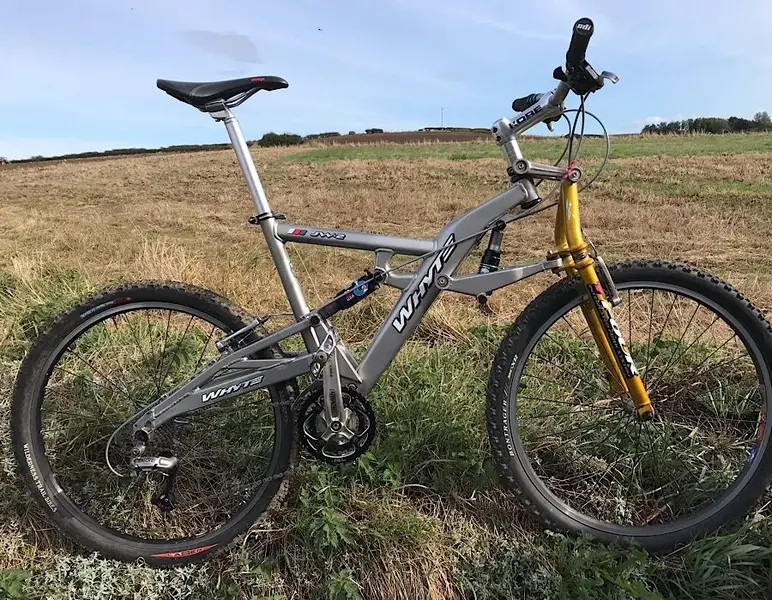

Managed to get bottom pin out. Top pin is fused to bushes. They rotate with it. Hammer (fairly forceful) wouldn’t shift it so plusgas overnight.......
Well after a little thought I devised a puller along the lines of a rivnut tool using an ever increasing pile of washers as I slowly increased the length of pin protruding. Allen key stop bolt spinning. Spanner turns nut extracting shaft on end of bolt. And. Success!

Air shock a huge improvement. Rear also set at higher pressure. Much less Bob from rear an zero dive at the front. Feels like you’ve set it too stiff but I aimed from a few holes and bumps and remarkably it coped really smoothly. Will take on a proper ride and report. Was worried it would struggle with my immenseness but so far.........

Well done with removing the pin. I notice your shock is mounted upside down compared to mine. Is that necessary for clearance?
Re: Re:
Yes there’s a valve and lever that hit the mount otherwise.
