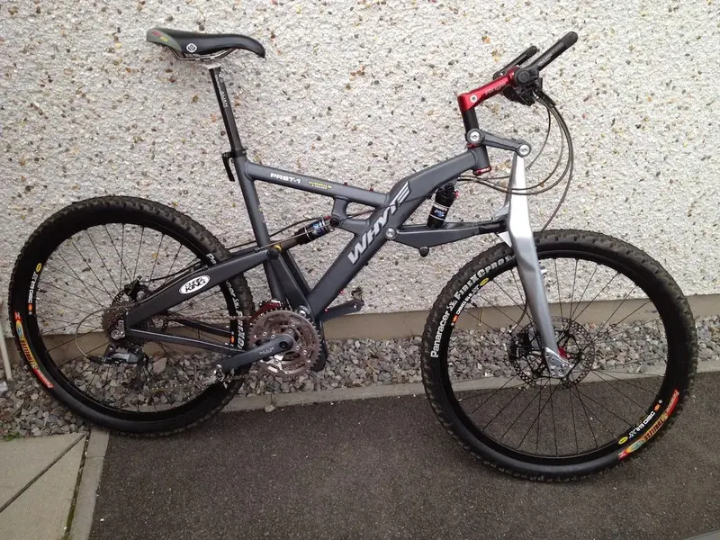

I've had loads of these over the years, they made them in: S - 17", M = 19" and L - 21"
If you look at the following pics you can see the differences....
The first pic is from t'internet and not my bike (the rest are pics of my bikes) and shows the original first-gen rear shock mounting point, these are the "most retro".
Then they did the MkII with the modified rear mount:
Production then switched to the PRST-4 with the different rear end (no chain slap), earlier versions still had V-brake mounts:
They eventually phased-out the V brake mounts and were disc only, looked a little cleaner sans brake bosses!
This pic is also a 21''-large, if you compare it to the pic above (19") you can see it's a taller seat tube.
There's no difference in length/reach though, the main monocoque is the same for all sizes.
The cheaper JW-2 didn't have the "big-gripper" dropouts or the proper "plus four" forks.
Cheers,
M.
