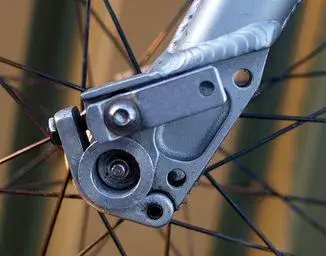

also watch out on the early prst's as the front and rear drop outs are specific to the hubs so normal QR hubs wont fit - so if you buy a frame and fork - make sure the hubs (at least) are included. I dont think this is the case on the later bikes and certainly not on the JW2

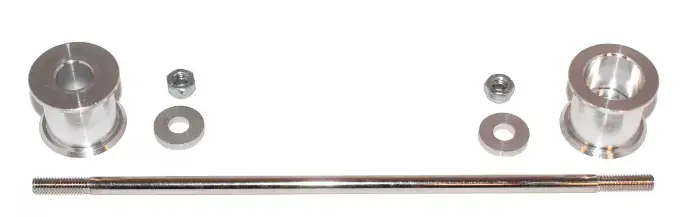

the early PRSTs as the front and rear drop outs are specific to the hubs so normal QR hubs wont fit - so if you buy a frame and fork
My early one (just frame in pieces at the mo) has the machined bobbins that are fitted onto any normal QR hub, held in place by a long bolt QR skewer. Whyte still sell this: https://whyte.bike/products/big-gripper ... sembly-kit
These are than clamped by the Big Gripper dropouts.
No special hubs needed, just need to make sure that you have the bobbins and (ideally) skewers.

I even converted a through axle wheel to fit my PRST4. I got some special end caps from my local bike shop and new bobbins and skewer from ATB sales. They only had rear so I cut the skewer and cut a new thread which I think was an M4.
The PRST always had the big grippers. They continued to use them on the "46". As I mentioned in my first post they definitely stiffen things up like a through axle does.
