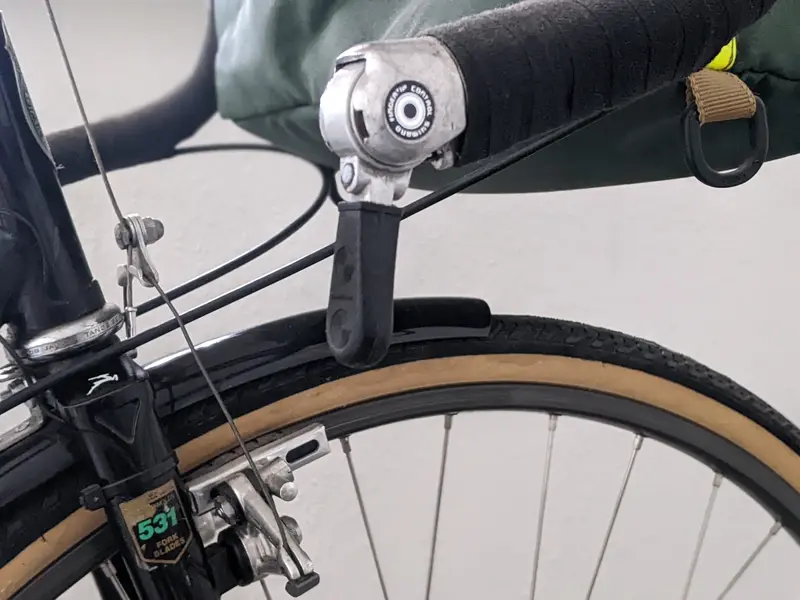

Did Shimano ever offer different ones than these and the current versions?
Their length is about the same. So they probably had different things in mind than clearance 🤔
