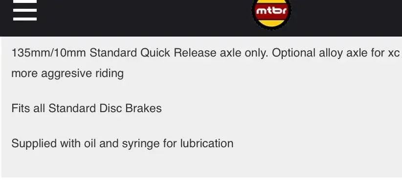

It you need a syringe to add oil it’s going to interesting
Like Fluffy has put - post a pic will be interesting to see

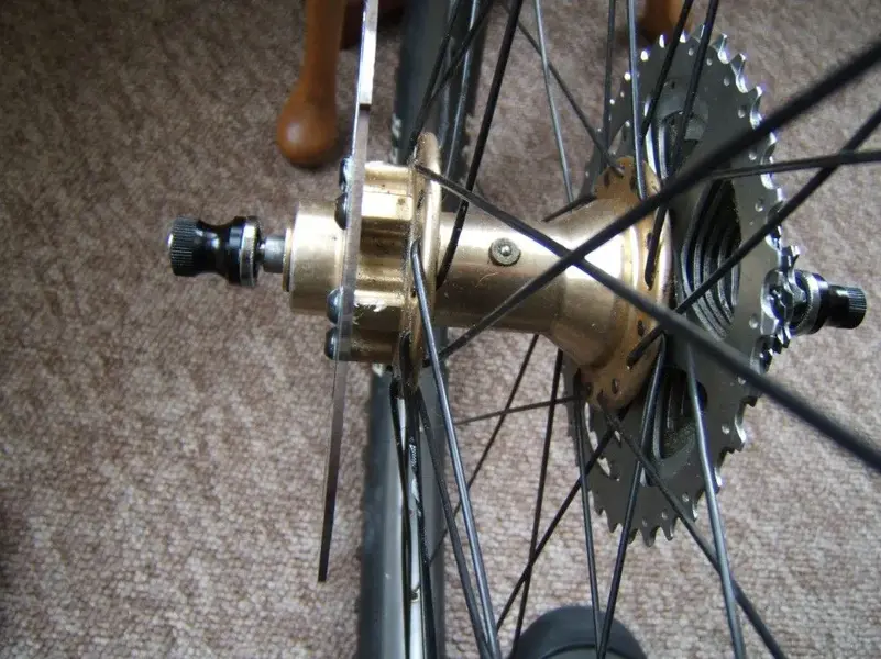

Piccy
Have to say though :lol: the internal views of the split and machined hub look tricky to say the least. Bearings are easy, axle as long as ok is easy, but its the freehub and tis one appears to be specific to goldtec though it takes shimano no probs.
There was a disc adaptor on ebay last year. Touted as Hope so i took a look and guessed it wasnt. Sat for sale for quite a number of relists.
Then Im fitting a rotor to the wheel and finding it isnt fitting. A bit of research shows the adaptor was a goldtec adaptor for this hub :facepalm: Had to modify it slightly with the dremel. Bloody typical, and likely an incredibly rare bit to find should you know what it was you were looking for.
