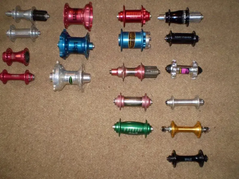

Dont really know about the disc versions, but is this the adapter you speak of, on the blue hub in the picture?

No, and now I think on it it might have been 6 to 5 bolt for hope rotors.
It was in a job lot of three, one touted as maybe hope.
