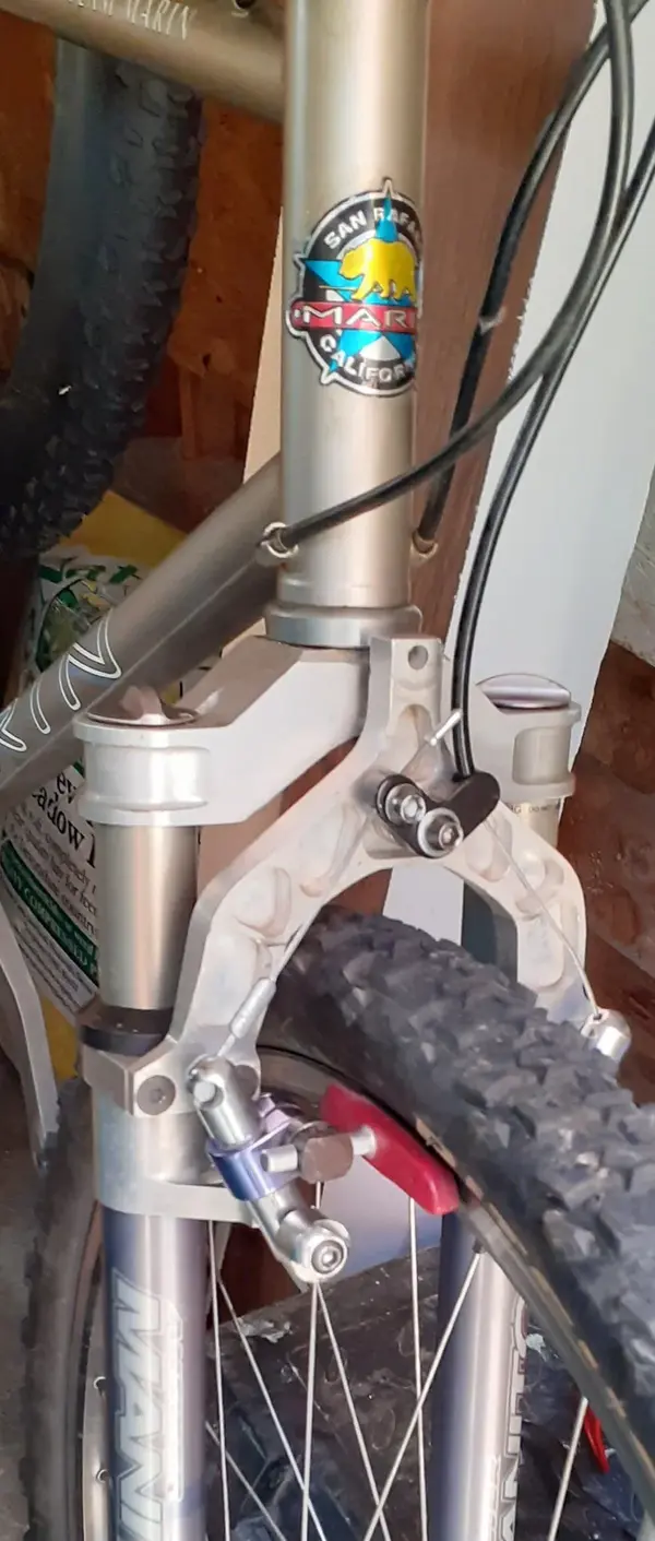

I bought these below from @d8mok and, they were easily tuned. Not cheap like thet used to be, but i dont mind as its my only bike. 20220411_144153.webp

Haha, no worries! FWIW...maybe look at early 2000’s Marzocchi’s? Less “period-specific”, but the travel performance of spring or air will be better than elastomer....just a thought.... looking forward to pics of the final build!
I think I will mostly likely end up with some Manitous, because I had some bitd and like them :)
