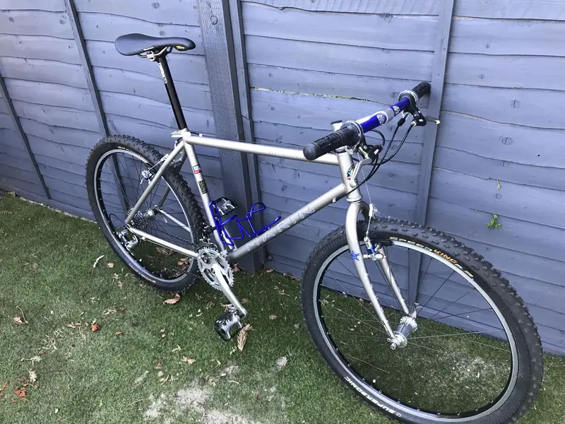

I had Manitou Mach 5s on my ‘95 Pine bitd. Controversial choice around these parts as a fairly unloved fork - but they were much stiffer than the Man IVs or Judy XCs that I alternately considered at the time.
Somehow Manitous on Marins just feels like the right choice - like Pace on an Orange or Rockshox on a GT.
That said, my Pine recreation runs the original steel forks these days. 4165E6FD-82F5-4455-9256-38FE3C3B0606.jpeg
