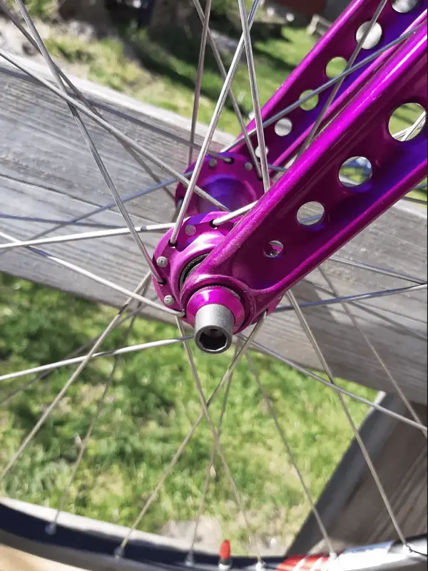

I have bought a new bike whit titanium wheel screw that I'm not familiar to... I would like to know how made them and how I release them... Please... :roll:

Those are Gonzo Mudslinger Skewers:
They came with a specific ratcheting tool to fit and remove them. This was designed to be an anti theft mechanism and is not an 8mm hex unfortunately.

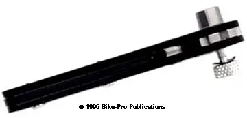

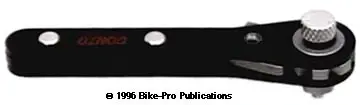

It was a specific tool with the bit built in that came with the skewers, I've owned a couple of sets in the past. I'm sure the correct bit can be sourced somewhere, it's octagonal.

I realise it is similar to the standard tool you mention. The ‘bit’ is not removable from the ones that came with the skewers, it’s built in and a threaded shift passes through the middle and tightens via a knurled knob on the rear into a threaded hole drilled into the bottom of the head of the bolt.
