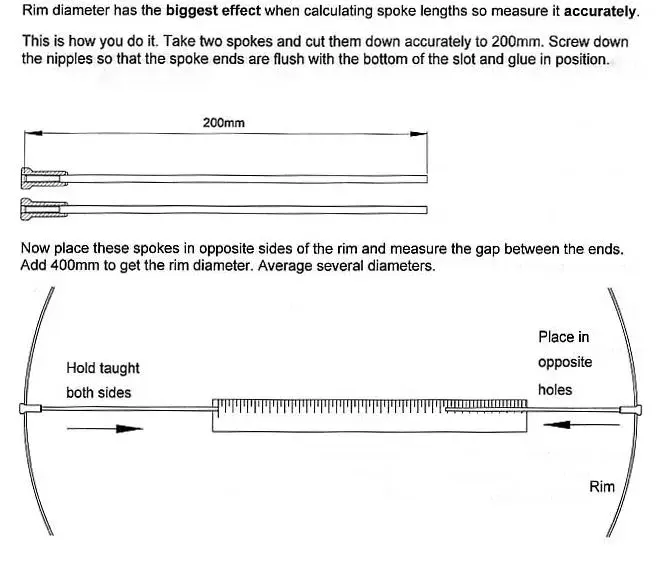

So long as you are getting close with the rule you are using to measure the hubs sizes, you won't be far off using a spocalc. Hopefully I've managed to attach an image of what I use to measure the rim diameter (effective rim diameter - ERD). Is the 300mm just for the front wheel, as you will be expecting 2 different sizes for the rear wheel because of wheel dish.

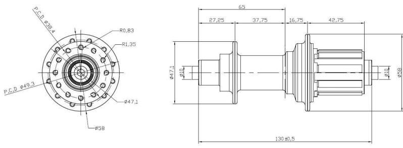

I´ll be happy to help, just need you to provide me some data: number of cross (spoke crossing), diameter of hub (hole to hole), distance from flange to flange both on front and rear hub.
very intuitive and accurate way of doing it thanks very much.

Front hub are measured from flange to flange, and then divided by two yes, rear hub is measured from where the hub sits in the rear fork
the pic to the right, measure the whole hub, and divide in two, then measure from flange to center of the whole hub, the 37.75 and the 16.75 make sense? The way I measure the rim is: Take a measure of the rim from outside to outside, lets say it`s 602mm, then measure from bottom of screwdriver insert in nipple to top of rim, multiply by two, and subtract from the rim diameter (602) That´s your ERD (effective rim diameter) Hub diameter is measured from hole to hole, opposite from each other.
right I've been doing some measuring, hope it's accurate enough. hub nut to nut 122.5 mm,left flange to hub centre 42 mm, right 17mm. hole to opposite is 42mm and erd 620mm. that everything?
