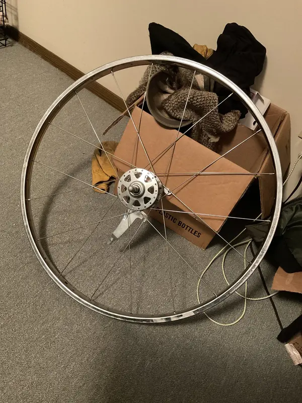

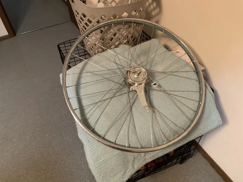

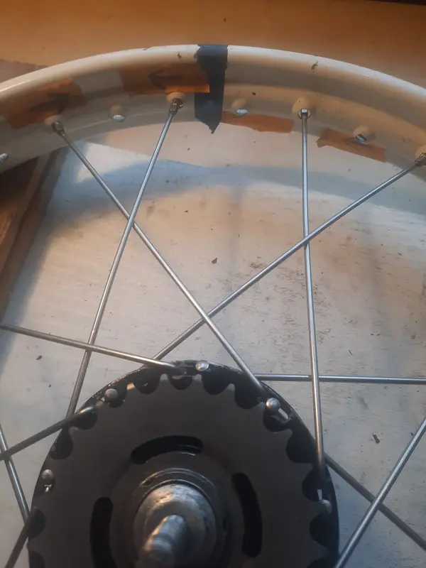

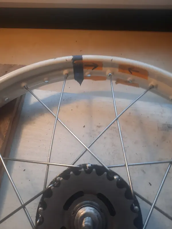

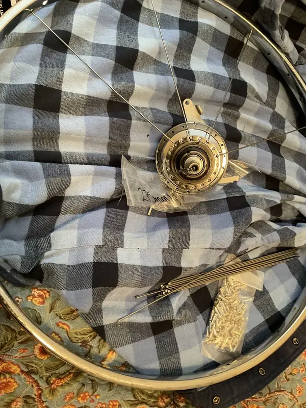

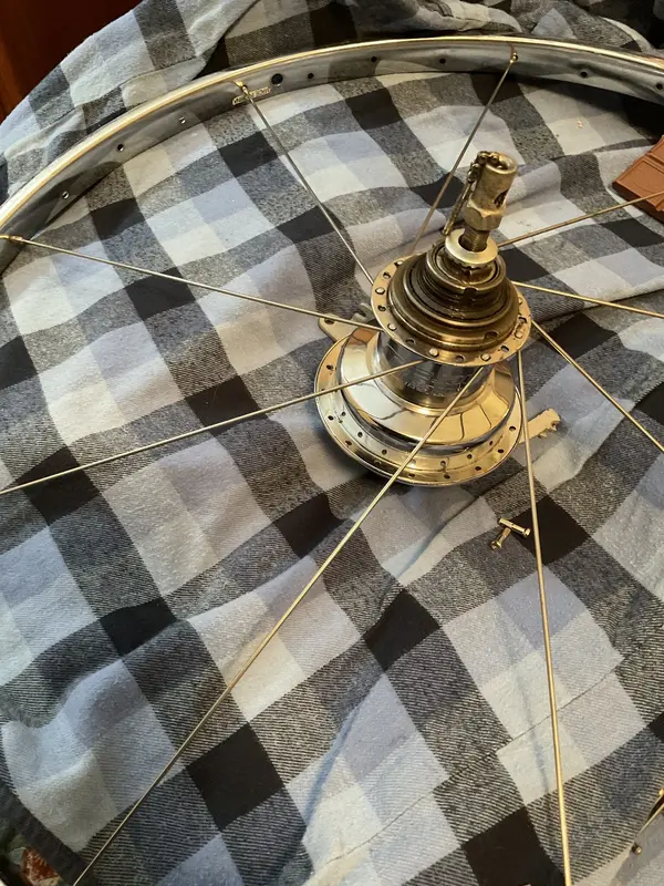

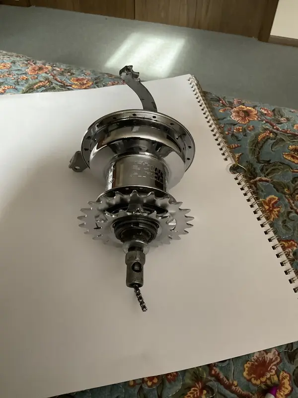

I don't have the old spokes, I eventually threw them away. If I have to reveal the truth, I built up this wheel 3 or 4 years ago after the rim had been repainted. My son asked me if I could build the wheel. He had already taken it apart without taking photos, measured and ordered the spokes. I came in at the wrong end of the project. I had help of a YTvideo then but I didn't find it this time. I don't think I dished the wheel that time either, they had to add a number of washers to the hub to stop it rubbing in the frame.Also, the spokes you ordered did come back exactly the same length as those you took out? And...the measurement was correct from the old spoke?
Do you still have the old spokes? And any photo of the bike with the wheel in you can zoom in on?
Got to ask.
I don't have a photo of the wheel before the refurb. They were actually able to ride the bike with the wheel i built right up untill this past autumn when the hub developed a crack and one of the flanges sheared off. The nightmare had returned
