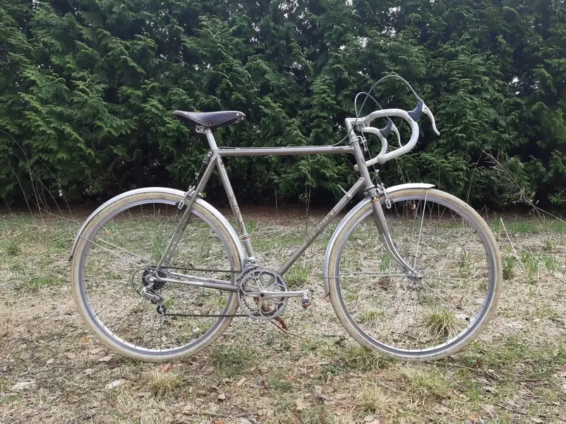

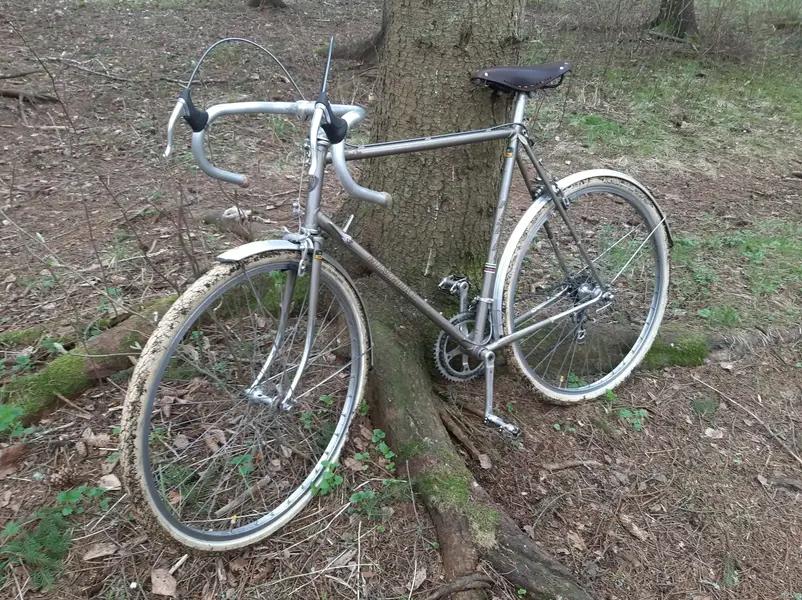

First test ride. The bike rides really well and that 24-42 seems to be enough to go up the biggest "hill" I would normally encounter here. Forgot the rear brake was still open after taking the rear wheel out and the qr was not tight enough so the wheel jumped forward and locked up. Good thing the tires are so big and I was going slowly so nothing bad really happened😁 After tightening those and the downtube shifters I did a 10km trip.
Not that hill...

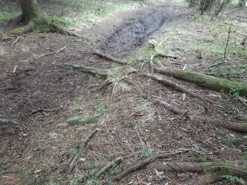

Little "gravel" riding or whatever cycling in 2" mud is.
View attachment 954483View attachment 954484
Tires are big enough to roll over large roots.

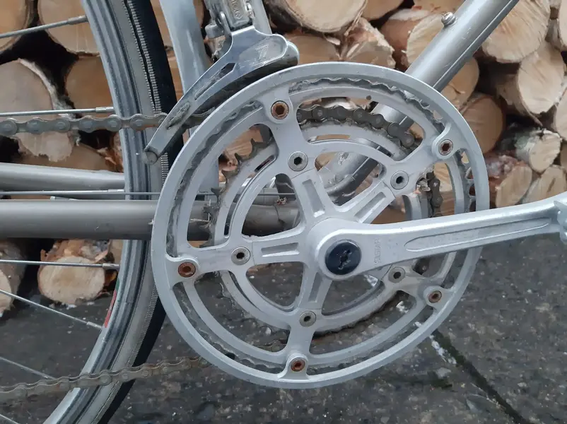

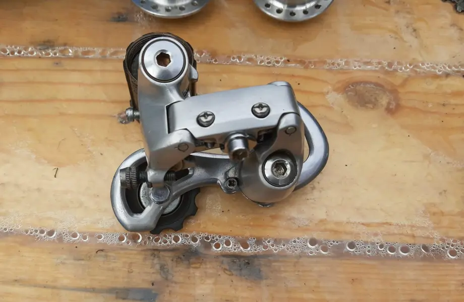

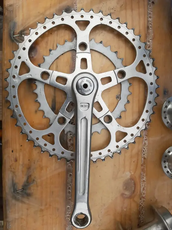

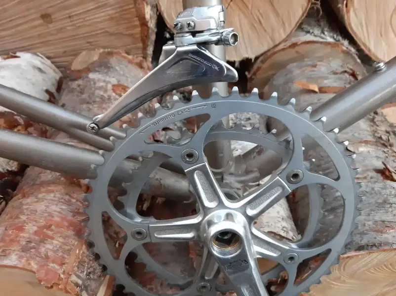

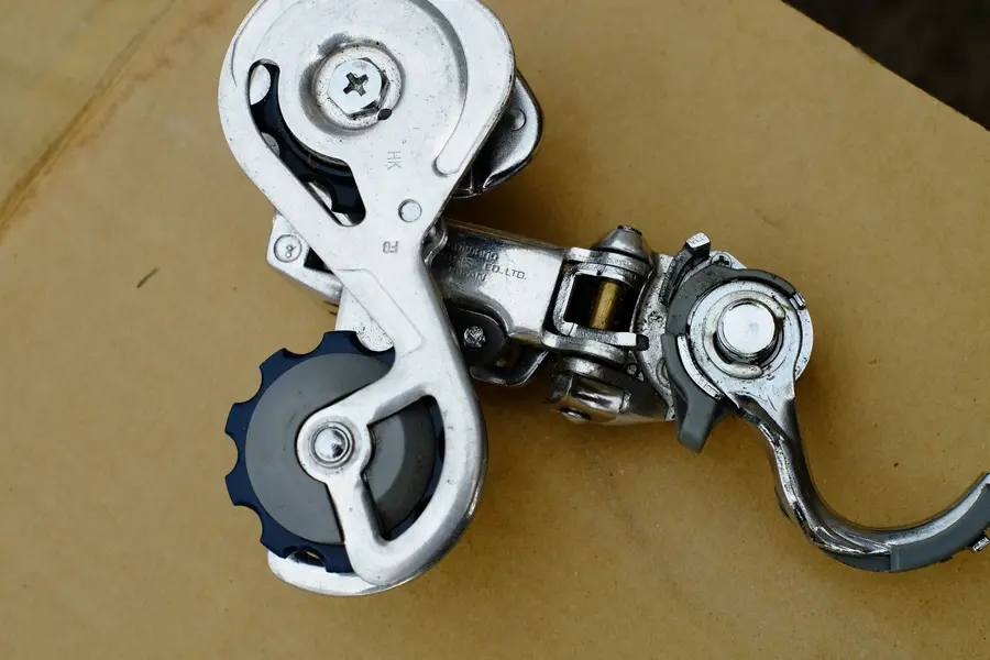

Grey cotton tape with shellac could work. Maxy cranks also cool and a useful 110 BCD? Is that a Superbe rear mech? Classy. An earlier cyclone would also slap.
I've been wanting to try shellac but can't justify the cost of 15€ per handlebar just for the shellac alone.
Yes those are 110 bcd. It's a Alpha 5000 that lost its print when I cleaned it so I just went on and tried to give it a brushed finish with brown scotch-brite. Design is similar to Ole and Cyclone 7000.
