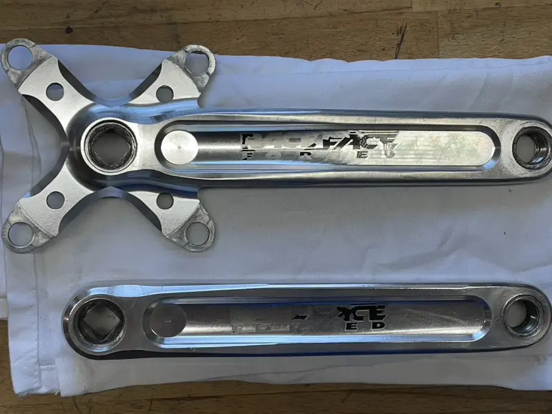

Thanks to stmoots on here I have a set of very nice Raceface Turbine lp cranks, thanks again 👍
After reading a bit online and searching on here it seems that Raceface had their own taper, not quite either of the common two standards, jis being the nearest it seems. I’ve looked online at replacement Raceface bottom brackets and apart from the algorithm directing me to Amazon to a shimano Raceface bottom bracket, whatever that is I can’t find anything definitive. I’m currently using an xt m750 crank with a 107 x68 mm jis BB, and I’m happy with the chain line and Q factor, I did offer a turbine crank arm up and it sort of works but the arm is closer to the chainstay. Has anyone on here found a source of Raceface bottoms brackets or does anyone know if Phil Wood makes one?
I have sent Phil Wood an email enquiring but I haven’t heard anything yet and it’s been more than 5 minutes lol D80A42C0-E24D-4666-A575-8BCC48B815D6.jpeg BD802C5A-E5A0-4C70-91BB-80EAA010EDB4.jpeg

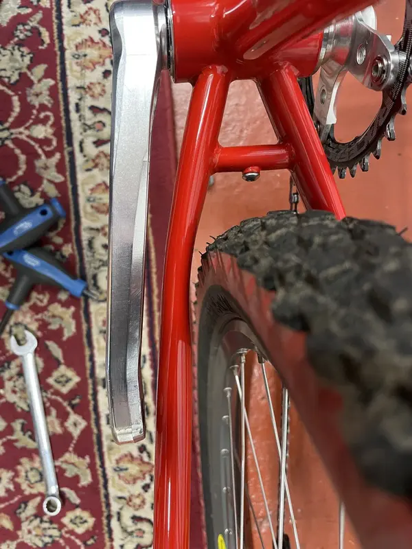

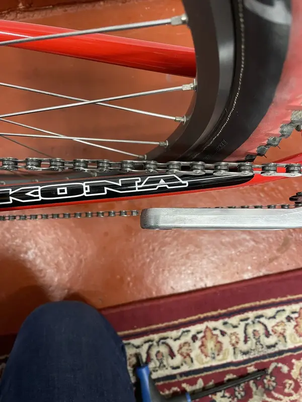

Thanks for that, its reassuring to know. I was a little concerned about ruining them. Because the non drive side arm ( only side I tried ) is closer to the chain stay than the XT or I would ideally like, do you know if a 110mm JIS would space the arm away equally each side so an extra 1.5 mm on each side?

Just remembered RaceFace TaperLock are ISO standard. They're just a bit longer than JIS really. Normally you see the opposite if the cranks are ISO on JIS bb.
Anyway, a 110 is just longer on the NDS side, DS side stay the same, unless you use a BB that can be tuned.
Archive for some info for cranks and the TaperLock BB.
So their standard is called TaperLock. If I was lucky enough to find a Raceface BB, would it be a 107mm axle length id need? Thanks for the link, looks like 107 or 110
