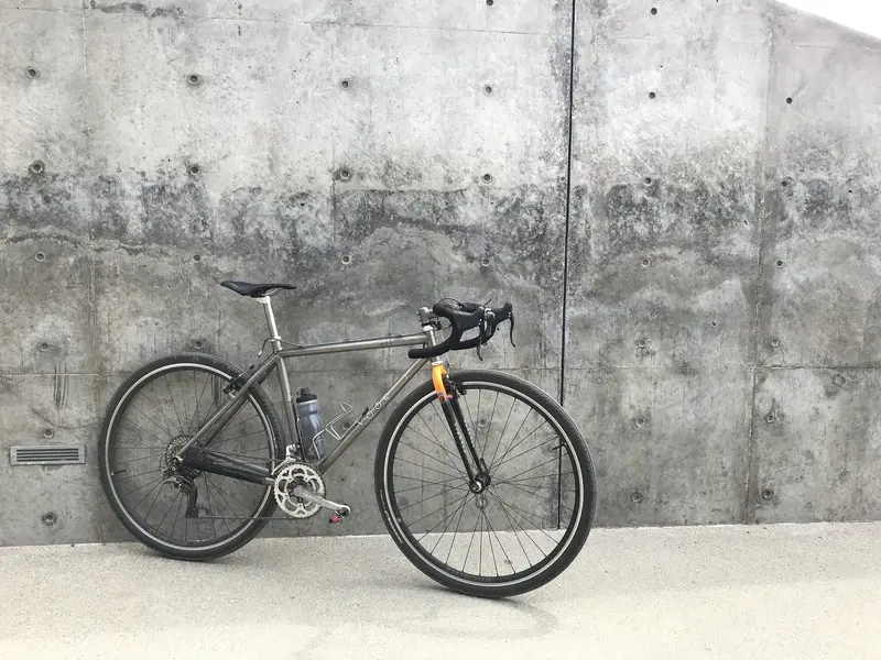

Cables and housing are Nissen. I'll look into the opti. Not sure of the culprit but not as nice braking as the setup on my OR. Feels a little spongey and not stopping as quickly...or maybe I need to squeeze harder.
OR - Paul levers, Yokozuna cables, Paul/XT calipers and koolstop pads.
Loa - Gevenalle levers, Nissen cables, Ciamillo calipers and SwissStop pads.
Nothing changed here other than the front mech. The ultegra snapped on the first ride and a campy was subbed in.

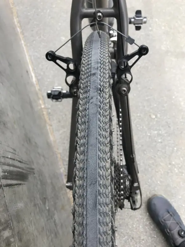

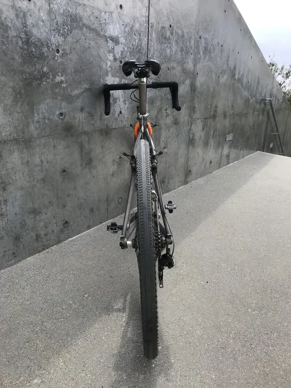

My loop has a few miles of gravel and loose dirt over hardpack and I’ve eaten it more than a few times. These tires aren’t any good for that sort of stuff so new rubber is on. Going to ride tomorrow and see what she does, will get a new pic.
Too bad with the tires, eh with the ultegra. At least you ride your bikes! :LOL:
What tires are you swapping in? More knobby toward the rolling edge or?
They’re specialized pathfinder pro in 700x38.
For sure an improvement in the loose stuff, even at 80psi. But after the ride today I don’t know if it’s worth the compromise (given my usual ride on this bike is 90% paved.) They’re quick on pavement but not as nice or quick as the UltraDynamico that I pulled off. But then, maybe it was just tired legs. Also I had latex tubes in the previous tires and butyl here which must count for something.
The fork is probably maxed out with these so if I eventually want those 42s it means a fork swap =\
I dig the chunk but I should have gotten the tanwalls.

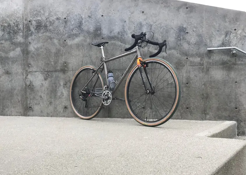

I've thought about this. I have another set of wheels that work, 700c with 135mm rear hub. Even though they're junky they could serve as a beater wheel for sure. Or I could have another nice set built up. I initially thought I had to build wheels because 135mm 700c wheels are non existent...then I learned 29ers can work 🤦‍♂️ No harm though, these wheels are super nice and worth all of the pennies, just don't want to throw that kinda money at a spare set quite yet.
In any case, the problem isn't swapping tires or anything, it's that my ride is often mixed with some road and dirt, just heavily weighted toward pavement but those bits on the dirt suck with the 33 slicks. I think the better compromise is to go back to the 33 slicks and suck it up.
