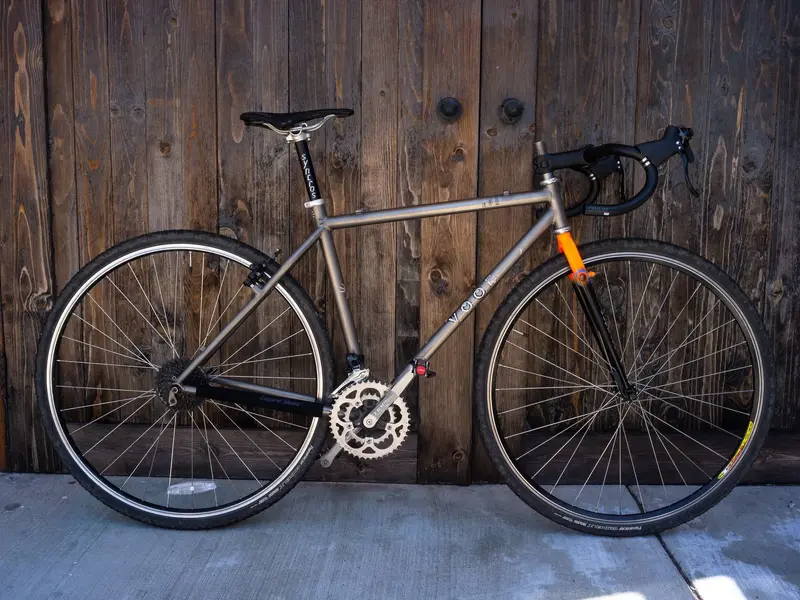

Gotcha, that all makes sense. I was a bit miffed when the tabbed washer didn't seat properly on the boss. It's square at the base of the boss but the welds kind of keep the washer from biting. But...I felt I was overdoing it with the thumbscrew so I just stopped before I ruined something. Better to find some guidance.
I'm nearly there. The ebay purchased stem shipped with stripped faceplate 🤦‍♂️ so that needs sorting. Wheels being built first thing next week and then cables...

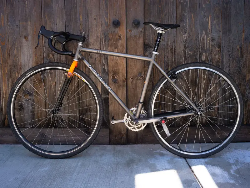

Meanwhile, I mock up.
Sorted the downtube shifter and kitted it out with all black hardware.
I've got 3 seatpost options and a couple stems/bar options.

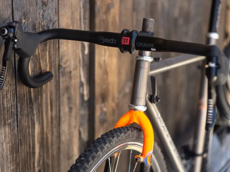

The previously pictured Nitto x Bluelug bars seemed great but after handling them and siting on the bike a bunch I realize the hooks are super short. When I get into the drop my hand nearly hangs off the back.
So I found a bargain on these Deda bars that were take-offs. They're modern obviously, not crazy wide but with a small amount of flair. Only problem is I lose the cross top Frogglegs due to clamp diameter. I could run a new set of Paul in line levers on this bar though =X
I liked this 3t stem for the rear facing bolts, clean I think, and the red 3t logo pops off for either stealth mode or to run a computer/gps mounted there. Lets hope the seller makes good and sends me a replacement faceplate.

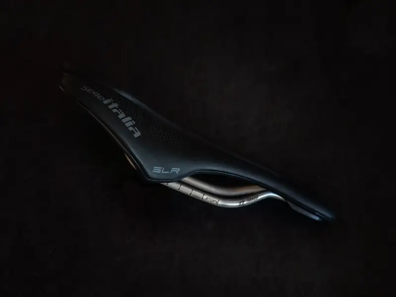

Those taint-saver seats I always found to be uncomfortable, so good luck to you in that the geometry works out. They are not for all people and I think require physiology where crotch is somewhat wider than average. I could have had a dud seat too. At the beginning of rides it was 'ok' even with a bit of ball butter, but after 100 km...eh no bueno. Not to scare you away...just promise yourself that if you get rubbing or pain where your inner thigh meets your nuts and taint that you stop using it and find something else.
Regarding the bike overall; looking good. You are cutting the steerer tube or shimming? Any ideas on bar tape and color?
We'll see how it goes but I am pretty optimistic that it will be better than some of the vintage saddles I've ridden. I bought the smaller/narrower of the two options which should make sense given I'm smaller than average. Maybe your experience with that particular saddle was affected by one of several other variables?

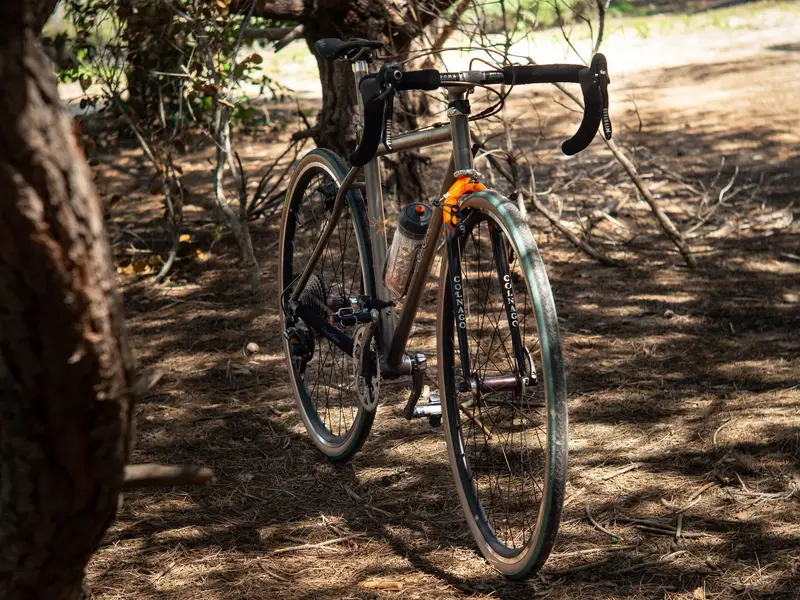

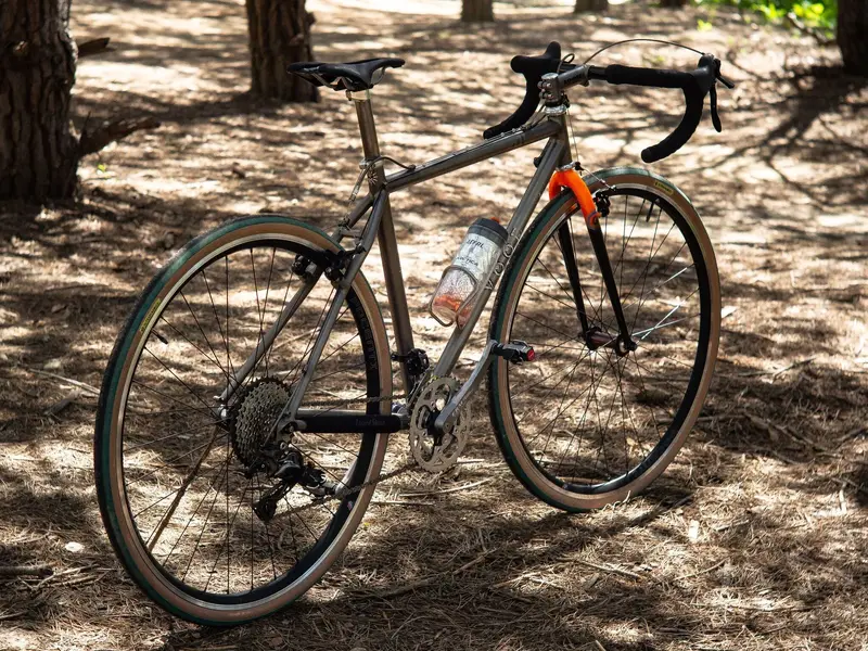

Went on the first ride today. The skewers I had planned, USE spin stix, didn't work great with these rear drops and the WTB cable hanger didn't work at all and probably wouldn't without several spacers. Oversight on my part. The current one is temp, routing still isn't ideal you can see. Need to find something I like better, suggestions for something that has a fair amount of drop? Skewers are m950 and I'll try to find a suitable replacement soon too.
Saddle feels great and the bike is a blast though it's kind of in this grey area of not being super capable off road while not being as good as I imagine an outright road bike would be. But, once I find the right road bike this will get some chunkier rubber and a little wider drops and should be good to go.
