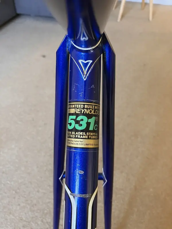

Hi Everyone,

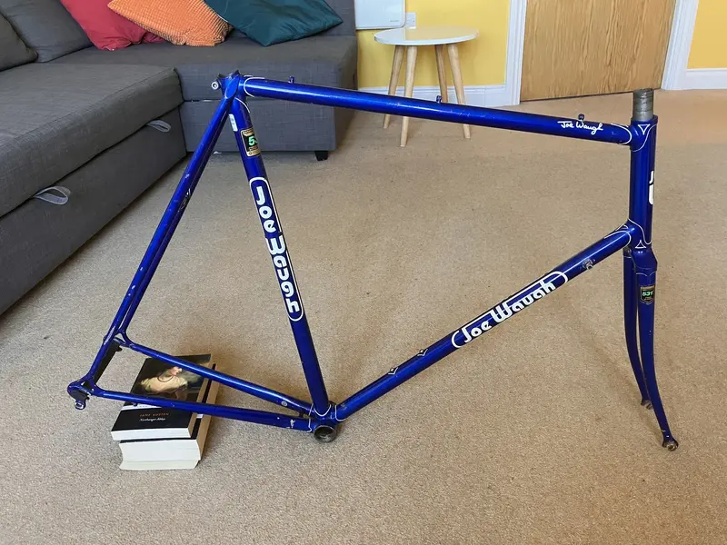

I have a Joe Waugh frame (531c) that came off EBay a couple of years ago and I’m finally getting round to doing something with it.
My plan is to get a professional respray, new decals etc and build it into a very nice example of a steel race bike. I don’t know the year but the guy I bought it from thought it was from about 86/87. Frame no is 2565 if that means anything to anyone.
My questions are to the great retro bike hive mind…
1 - who would you use for a respray and to check the frame and forks are true and safe etc before painting?

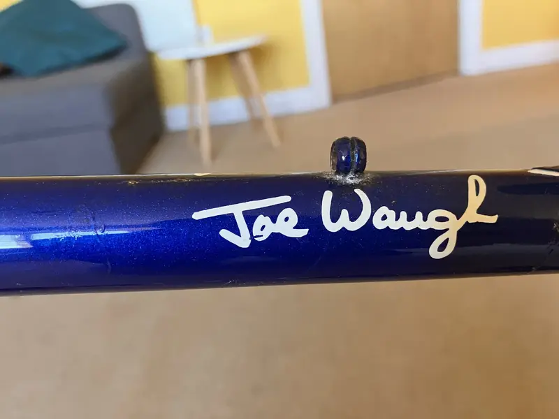

2 - I’ve never been a fan of cables routed over the top tube, is removing the three cable guides and replacing with 2 split cable guides under the top tube a terrible thing to do? Like putting pvc windows in a listed building. If you were getting this sort of thing done who would you recommend? I think it probably is a bad idea but I’m just airing my thought process.
3 - what groupset would you choose? I’m a big of a fan of Shimano and I’ve been thinking of Dura Ace 7200. Would this be considered too high end for a 531 frame? if you’re a Campag fan, what would you recommend? I want to go for 1980s downtube shifters and preferably indexed.
4 - what’s a good rim/wheelset to look out for? Clinchers or tubs? (I’ve never used or even ridden on them)
5 - all the other bits, recommendations for bars, stem, brake pads etc
I’m not building a daily ride, more something to get out on dry days, club rides and Erotica type events.
Any help much appreciated
Jim

1: Argos in Bristol
2: just do it. Some cable routing fashions were no good.
3: 531c is a top tubeset for the period. Dura Ace is entirely suitable
4: tubs feel fantastic, but punctures are a pain.
I haven't had a puncture on tubs for over 1000 miles (👉🪵) but I wouldn't use them every day, through the underpass, or just after the hedges have been trimmed (also you can buy the wheels for very little because all the racers used then back then, but almost no-one wants them now.
5: go Italian on the finishing kit. Campagnolo post, cinelli bar and stem etc
6: check for a typo in that penultimate paragraph...😉
Thanks Bike workshop, all good info. Are tubs still readily available? Are they straightforward enough to install etc? I remember hearing horror stories about them coming off the rim. I’m guessing most of its urban myth, like I’ve heard carbon frame all snap, even though I’ve only ever seen evidence of it once etc.
No typos were found, you should see the clothing at these events😉
Tubs still available, but not cheap ones any more.
We stock one from Vittoria, about £30iirc
They feel like a larger tyre, but the wheel setup is lighter and rolls faster
😍... on a vintage racing bike.
Racers used to glue them on with shellac (i have done this) and some would scrimp on the glue to save weight. Additionally if you took a tyre off you might not bother spending hours getting the old glue off.
Nowdays I'd recommend double sided tub tape. It's fun to do too, and they won't roll off.
Any poorly maintained bike can become a death trap, and the owner often blames the component🙄

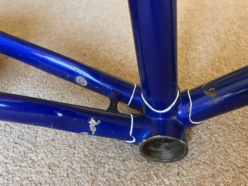

There’s no rust so I would advise a paint touch-up and then buff out with course rubbing compound. I like originality with a patina of age but that’s not to everyone’s taste.
80s campag looks great and stylish but works nowhere near as good as indexed shimano. Note that DA 7200 isn't indexed, its just friction shift. You need DA 7400. But this won't be cheap. Personally, I'd go for Shimano 6400 aka Tricolour. It works brilliantly and bits are still quite common and prices sensible. And it was typical of what a club racer would have had in the 80s
I’d definitely think seriously about Argos as they check alignment tracking of the frame, ream seat tubes, face & tap bottom brackets if required, face head tubes, inspect any pitting of frameset, run a die down fork tube threads etc…this before any respray. Your frame will be good hands under Mark & Garry 😎👍
80s campag looks great and stylish but works nowhere near as good as indexed shimano. Note that DA 7200 isn't indexed, it’s just friction shift. You need DA 7400. But this won't be cheap. Personally, I'd go for Shimano 6400 aka Tricolour. It works brilliantly and bits are still quite common and prices sensible. And it was typical of what a club racer would have had in the 80s
Thanks Pigman, that’s all useful info, Shimano it is then. The prices for 7400 seem pretty varied with complete group sets going on eBay for anything from £250 to almost £600.
Thanks mate, I definitely want it checked before spending any money and time on it.
Really like this, my size and favourite colour too!
I’d be at that with some polish and a nail varnish or touch up pen where the paint is missing. Appreciate not seeing it in person but it does look just on the side of being rescued rather than repainted. Though if you’re having the cable stops changed it makes sense to repaint. Are the bottle cage bosses a bit low down? Could just be the size of the frame.
That colour frame cries out for a silver groupset I think? I love 6400 Tricolor and have a couple of bikes wearing this but wonder if the grey finish would look right. Dura Ace 7400 or Campag Chorus would look great. I don’t use either enough to comment on how they perform. The bike I have with 8 speed chorus shifts brilliantly don’t know how it compares to 7 speed.
