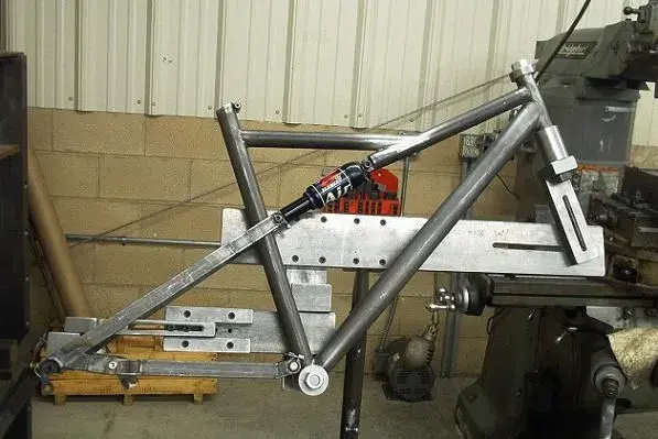

I've been riding hardtails for years and have never felt the need for a xc full sus bike, until this last year. Maybe I'm getting old, but those 7 hour epics are really taking their toll on me. So, I decided to build up a new ride for myself.
Does it count as retro if it's build by guy with an oldschool attitude?

Should be a functional ride with a nod to the past. Here's what I've got done so far....

Vitus VTT. Not sure as I've ever even seen one in the UK. Used to get the bonded vitus road bikes.
Nice custom job Rody. Certainly has that retro vibe :D . You build many full sus rigs? What forks ou going to be running? Look forward to seeing the bike completed.

yes, the rear triangle is aircraft 4130 as well. Straight gauge .028 wall, .5"x1" rectangular box. The rear end pivots on abec 7 sealed bearings in a classic Horst Link design. Using breezer drops and a custom disc tab.

The front fork is a Fox terralogic 100, a bit more suspension than I've ever had but heck, I deserve it.
Progressive 5th element for the rear shock.
Had thought about turning down my own headset in the lathe, but when I can get a King for 100 bucks, it's not worth the time.
I'll take some pics along the way and keep you guys updated. Only have an hour or so at the end of the day for me so it will take a bit...also building a big one inch replica and a one piece bar stem for my Yo. Too many personal projects right now :roll:

Rody, looks very yeti ASR, style but without the swinglink. I guessing its going to be pretty stiff made outta plain gauge steel! (which is good coz side loading on the shock without the swinglink on the ASR (or racerX which is pretty similiar) would lead to some massive shock shaft wear.

Nice one Rody. Looks more Titus Racer x than ASR to me (Horst Pivot - hope you've paid Specialized!).
