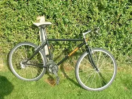

I've just been looking at Cannondale Kings lovely Clockwork project and very nice it is too. His 91 clockwork frame bares an uncanny resemblence to my 93(?) Prestige. What are the differences as mine looks the same? Could someone have made a mistake id'ing mine? How can you tell them apart?

Post up some pics and it will give us a better idea of what you have.

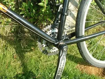

omg, i have no chainstay bridge...and my frame has a high pitch sound in the tubes...i thought it was a clockwork, could it be a prestige?!

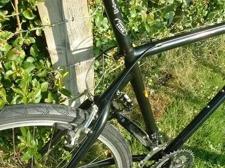

Well the pictures show it a V-brake specific frame, so I have no idea. Far too late an orange for me.
ddidds, could be :| but I have no idea what they did to them after they turned in to the P's and C's
Prestige or Clockwork?
What makes my frame 'v' brake specific? Is it the lack of a rear cable stop? The frame must be fairly early as its 1" steerer. If I can decifer the frame number and send it to orange will they be able to give me a answer?
