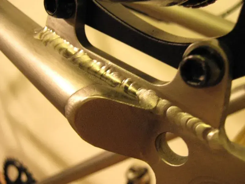

I've done this on a 1995-ish Parkpre Ti Pro Elite.

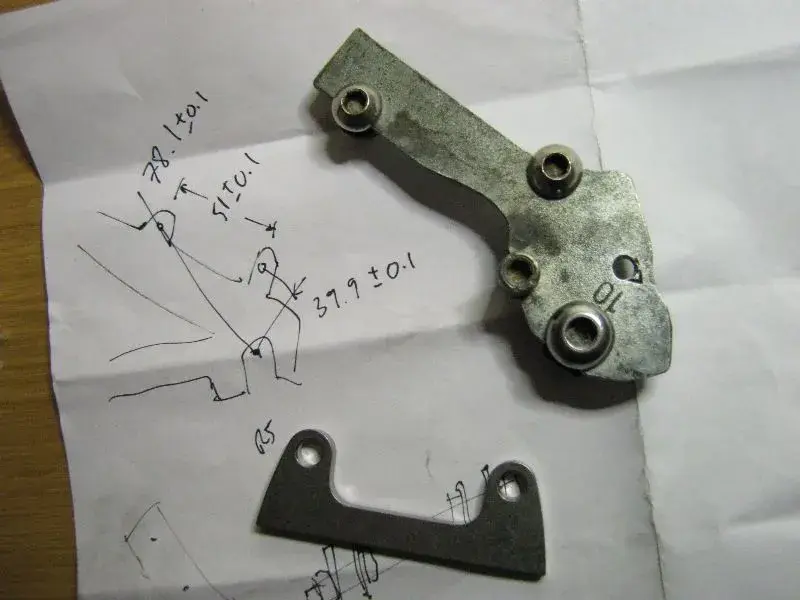

I made a jig out of an old steel headset spanner, got a Ti disc tab from Paragon, did the tab "maching" myself, then
found a good local welder (experienced and certified in the aerospace industry) to put the disc tab and a cable guide on.
Worked fine......well untill an earlier repair (done by ?) around the BB cracked, so the frame was subsequantly scrapped.
I've got another disc tab for another build - won't hesitate to do the same again.

mechanical_vandal":29so864e said:
Isn't rotor clearance going to be the biggest issue here?
Not really, konas have crap chainstay clearance, a 2.1 tyre is snug, yet I'm running a 185mm disc at the back with no issues.

I've given this a fair bit of thought for a future project.
Whereabouts are you? There are more frame builders in the UK than you'd expect however they tend to be quite busy, alternatively a competent welder could tig or braise it for you but the frame builder will have a jig to keep everything aligned. You can buy the mounts online for between £5 & £20 just search for frame building supplies or you could make one out of a bit of steel, some chain drilling and an afternoon with a file if you want something a bit more unique. I'll probably go for this one, as I like how it runs up the stay:
the jig could be a hub with disc rotor fitted and a brake calliper fitted to the tab with brake applied using an elastic band, include a couple of shims to allow for any adjustment in case there is any movement of the tab during welding..
a couple of tack welds either side of the disc brake tab should keep it in place for the final welding
you may want to include a brace between the chain and seat stays - useful to strengthen non-disc frames.
I was thinking the same... If the hub and rotor are in the frame and the calliper is bolted to the mount, once the calliper is mated to the rotor, everything should line up correctly (in theory) and can be tacked? I will still get a professional to do this as its not worth messing about and I will definitely be getting a brace put in too.
