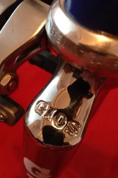

Amazing, there not too far from me, I'll give them a call, couple of pics attached of the offending articles!

Yeah, he'd done a good job, I used a guy in Sheffield called Martin, he's based in Portland Works, he actually only does polishing work on Motorcycle parts usually but he also turns his hand to smaller jobs with bikes… as long as he likes what he sees! - top bloke, just don't ask him to polish any car parts! haha
