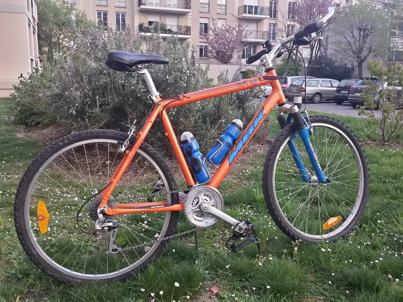

I found a photography of my MBK Stone Cruiser Sport AL, aluminium frame and Acera groupset (not the full group)
Heavy elastomer fork but global look was nice
