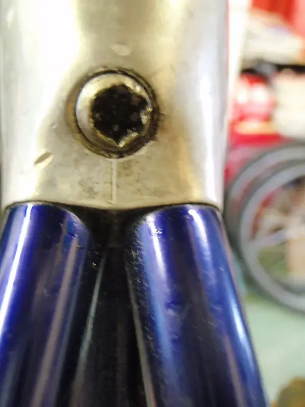

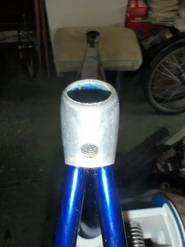

Had continued to soak the grub screw / seatpin in Crack It for the last few months - trying every so often to twist out the grub screw - yesterday, it finally cracked!

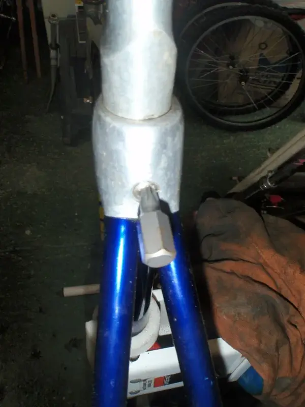

In the end, once it had started to move, the grub screw came out with ease. I had really hammered an oversized Torx bolt into the allen key opening, and given it a little bit of welly with a 10mm socket and a ratchet wrench.
The real fkr was the removal of the seatpin, which was defo a 2 man job to hold the frame still whilst you really had to twist the little sob. The bottom half of the seatpin was green! The crack-it also managed to free up the top of the seatpin too, so this has also now freed and the saddle is released too....
So, patience and attrition was the order of the day - plus the freezing effect of the CrackIt seemed to work in the end for me too. Most important thing was no damage to any of the parts too.... result.
