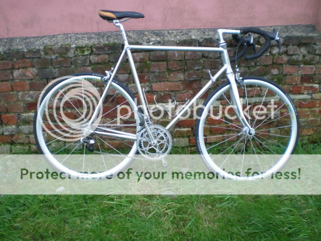

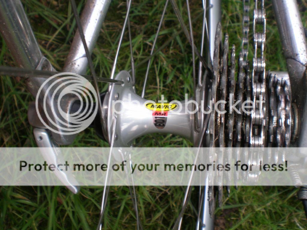

Well I have built new wheels from Mavic MR601 24H front and rear hubs and Mavic CXP14 rims. The spokes are sapim CX-ray with alloy nipples. I am using an old pair of Conti GP4000s at some point some Michelins, tyres and tubes will be fitted. Might even fit mavic rim tape. The cassette is cobbled together Shimano 10 speed 105 cassette. The chain is now a KMC x10-SL. Weight is 9.10 kg.
Next job is to fitt the Mavic Chainset and BB, but I really like the middleburn chainset.
can anyone suggest a French seatpost in silver alloy? Saddle has got to change as well. Any other French saddle other than Giles Berthoud.

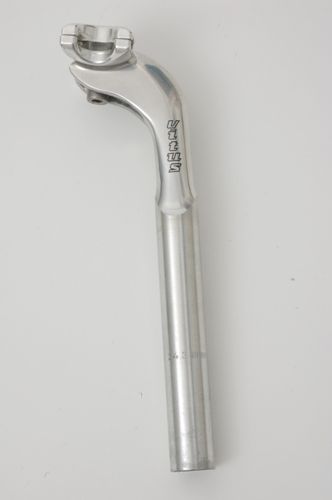

the seatpost is mentionned as mavic, but I doubt it as Mavic seatpost is black.
This is surely a vitus seatpost which looks like this
This seatpost was also seen as bearing the brand clb

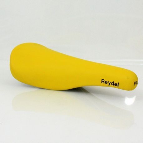

Possibly a french model you could find is a Reydel. I suspect it has been manufactured into the 90's
You can find a "Pro" model or a "GTI" ! probably to surf on the wave of the 205 or Golf GTI :lol:
here is one NOS for sale - it can be found in black too
http://www.cyclollector.com/fr/selle/17 ... jaune.html

I like your idea. Having ridden it again today 86 miles of windyness, all can say is wow. I should make this my race bike as it is perfection but that would mean fitting a different groupset as I can't race with D/T shifters.
The one thing I have noticed is how stiff the frame is, both laterally in the BB area specifically and in every direction in the headset area.
Simply a joy to ride, why again with a bike like this did vitus go bust?
