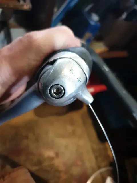

RX100 shifters woes - any advice?
They are always triple - the st-a410
3x7
The only option!
Both are working ok - tested with cables. IMG_20250412_144002.webp IMG_20250412_143958.webp
Most unusually iirc shimano sti triple levers always end with the number 3
Except these ones!
I found a few other levers in the drawer, but they had died and were spares only
Did you consider using a tourney st-a073 3x7? Although they are £140 new you might be able to find a good condition pair on ebay.
They are comparatively a bit horrible, but almost 30 years younger...
Otherwise there's our st-a140s😃
To be fair to the po, these shifters often work fine until the bike is hung up in the shed over winter.
Like hydro discs, shocks and full sus pivots...
I have and I haven't
They would work but as you say, they are horrible. There is no two ways about it. And they have the thumb lever for downshifting...
I am waiting to see if the PO is willing to send a refund. If so, I'll get the st-a410 shifters. If not...I'll convert it to downtube shifters.
Really? I never had it happen. But I never stopped using the bike for more than a couple of weeks.
