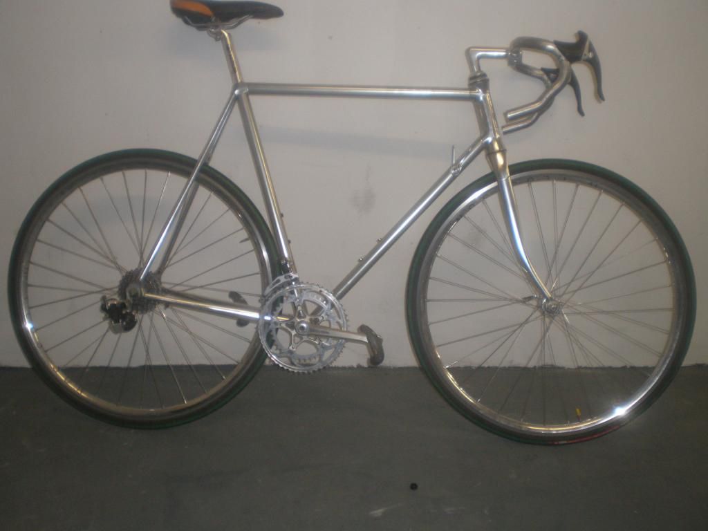

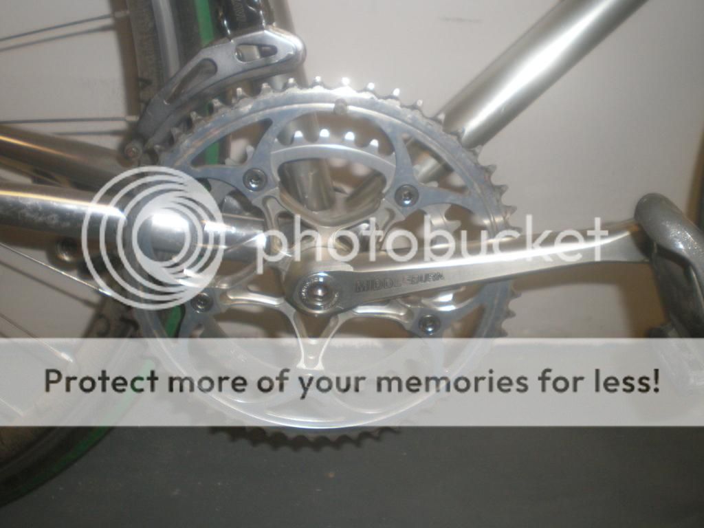

some progress. I have fitted the middleburn RS2 chainset I have with a Shimano Dura Ace 7400 53T ring and a stronglight 38T inner. The BB used is an SKF Ti axle 107mm which surprises me, I thought these chainsets required a longer BB. The RS2 chainset on my MTB needed a 122mm! I have also used ti crankbolts.
The wheels on there currently are Campagnolo Chorus 2006 hubs laced to H plus Son archetype rims with sapim laser spokes. The cassette is a Miche 11 speed so I will be friction shifting on 11 speed. I have decided though that I am will buy a pair of Mavic GP4's in 28H to lace to the Hope Ti Glide hubs I have. The Sachs 8 speed freewheel I have will be used with that. Oddly enough those wheels will be a fair bit lighter than the ones on there currently. I am still waiting for the Mavic 440SSC brakes to arrive and I have bought a Mavic starfish chainset but I am not sure if I will use it now. The stem is a cinelli A1 and the bars are 3ttt podium. Modolo brake levers complete the kit currently seen (these modolo levers are the same appart form the colour as the mavic 440 SSC levers).
I need to find a period seat I like bit otherwise I like it.

Well I found a 177.5mm mavic chainset! Mavic hubs seem hard to find. They often are 126mm and this frame a 130mm rear end plus I do not want to be restricted to 7 speed. The hub I bought for a £10 turns out to be 126mm and in need of new bearings. Good thing it is was teener. I'll find a use for it one day.
The cassette I have at the back is 12-27T. the threading on mavic 501 hubs is normal freewheel threading as far as I know.
