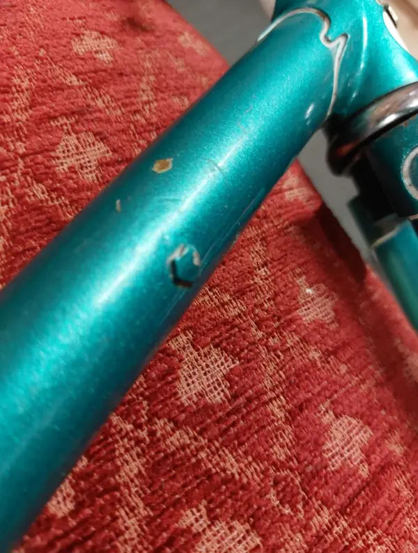

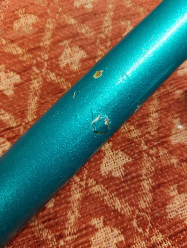

There is also a small raised bump near where the downtube shifter goes that is interesting or weird looks like it could have been a braised version at some point, I will take a photo and share as I'm sure it's been seen before and has a purpose or reason

The stop on the down tube is to stop the band on gear levers sliding/moving on the tube.
I think it is a very late 50s/60s Viking. The lugs are correct as are the drop outs. As has been said many builders used the same parts, so we may never know. Build, ride, enjoy. I think it will make a very handsome bicycle built up.
Amazing makes perfect sense and I thought I had seen it on other bikes but just couldn't connect the dots here it is for reference
