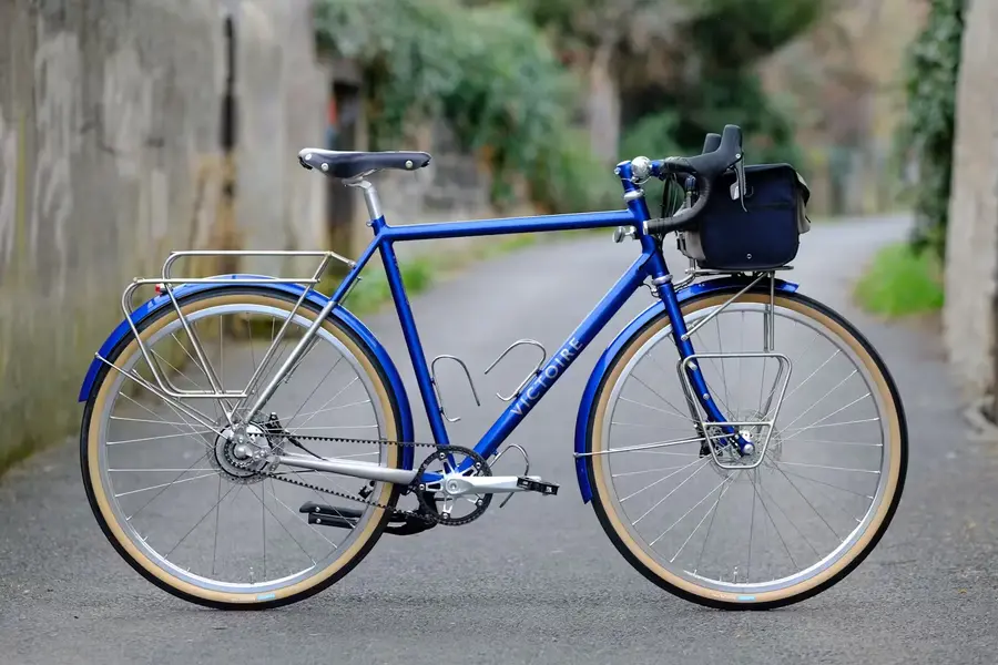

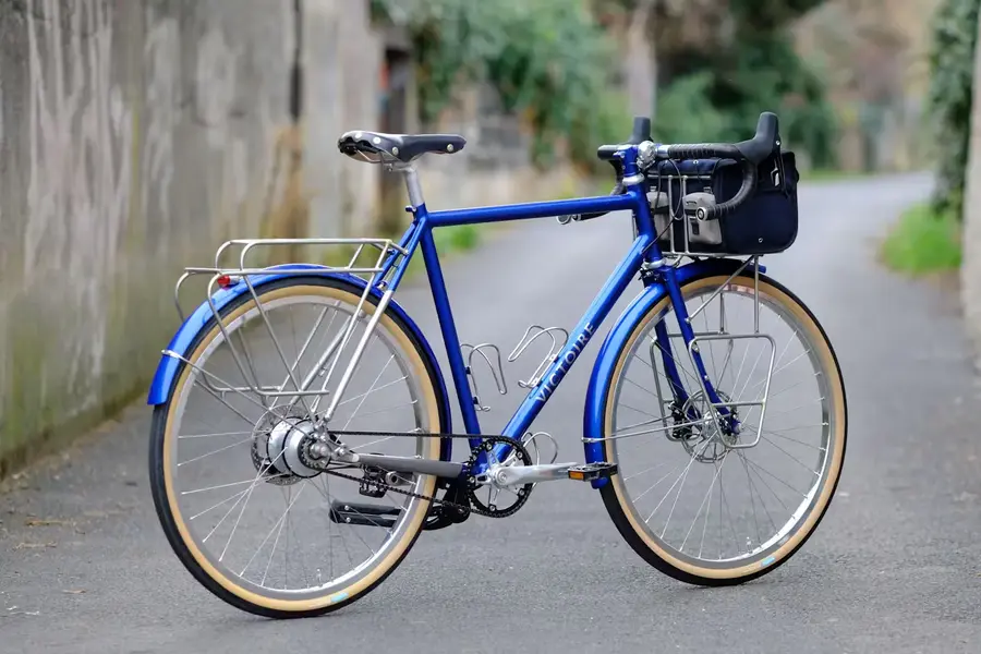

Gabriel, great lover of craftsmanship and epicurean cyclist, has decided to entrust us with the realization of his companion of getaways. Above all, he wanted a comfortable bike and left us a lot of freedom on the realization choices. Gabriel's Victoire 469 is a timeless bike, blending vintage aesthetics with modern, reliable and functional components.
This hiker is a reinterpretation of the typical French artisanal bikes of the 40s to the 60s with particular characteristics : leather saddles, no (or very little) sloping, steel fork and stem...
These years represented the golden age of cycling in France, with craftsmen such as Singer, René Herse, Charel or even Bourdel, originally from Clermont-Ferrand.

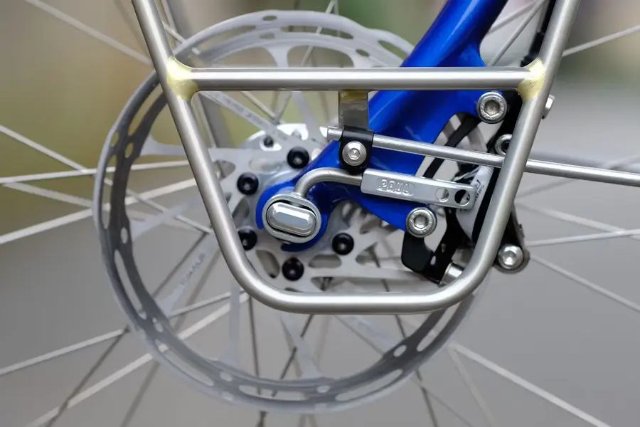

This traditional aesthetic does not exclude the use of modern equipment. Gabriel's hiker is thus equipped with a Rohloff hub. Guaranteed for life, this belt-driven system requires very little maintenance and features rock-solid durability. It is the ideal system for the use intended by Gabriel. As on all our traditional hikers, the frame, the fork, the stem and the set of luggage racks are entirely made in our workshop. Creating these parts ourselves allows us to have total control over the geometry of the bike, but also to integrate everything the customer needs : eyelets, mounting for bell, attachments for disc brakes, location for a headlight.

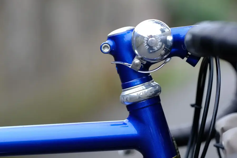

Original creation from usd (??), the headset (Stem GIGFY) is freely inspired by the design of the ones manufactured by René Herse. It is made up of three steel tubes, which are the source of the Columbus MAX shrouds. We offered this model to Gabriel, who was won over by its aesthetics.

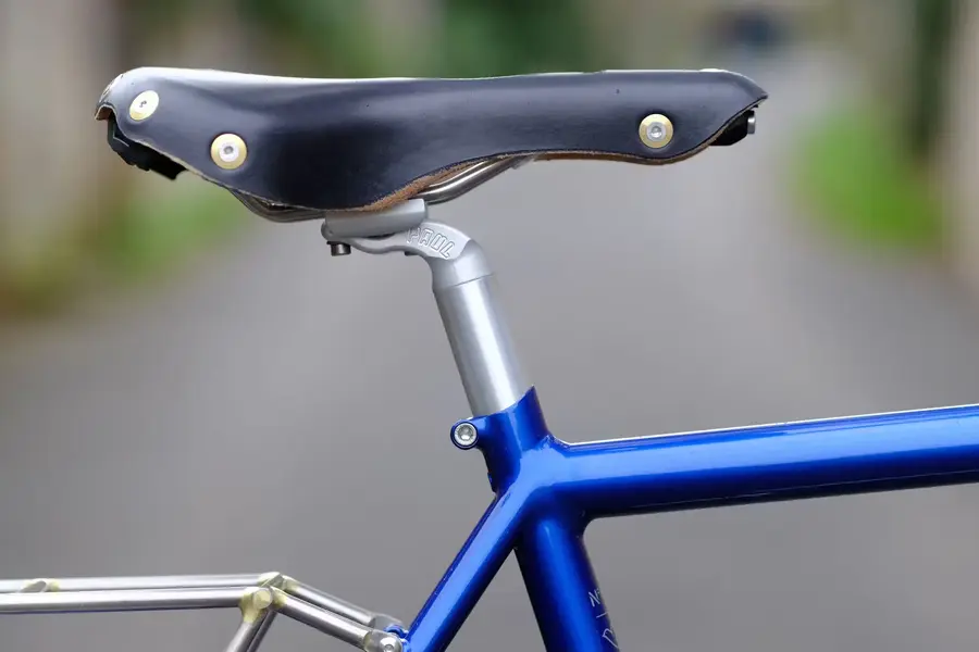

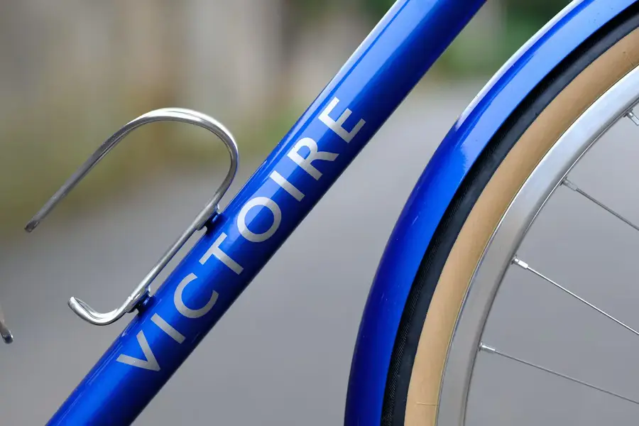

The frame is made of Columbus XCR tubes. This stainless steel allows us to make the work of the material visible. The brazed cords are the soul of our craftsmanship and Gabriel wanted them to be visible on the rear triangle of the bike.

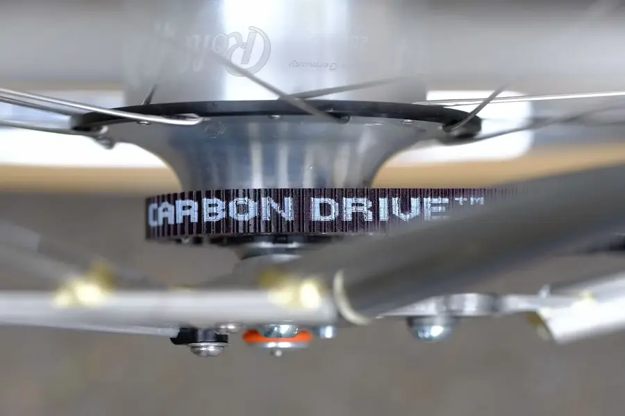

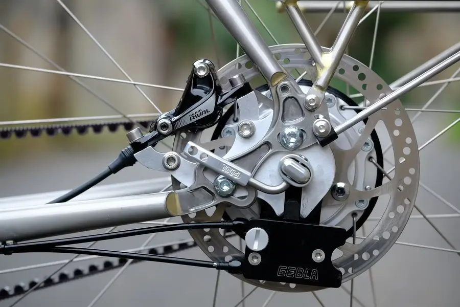

A belt does not drift (Split??) like a chain. So we had to design the framework to let it pass. The Rohloff hub requires very specific dropouts. The made-to-measure manufacture allows the frame to be adapted to this type of particular component.

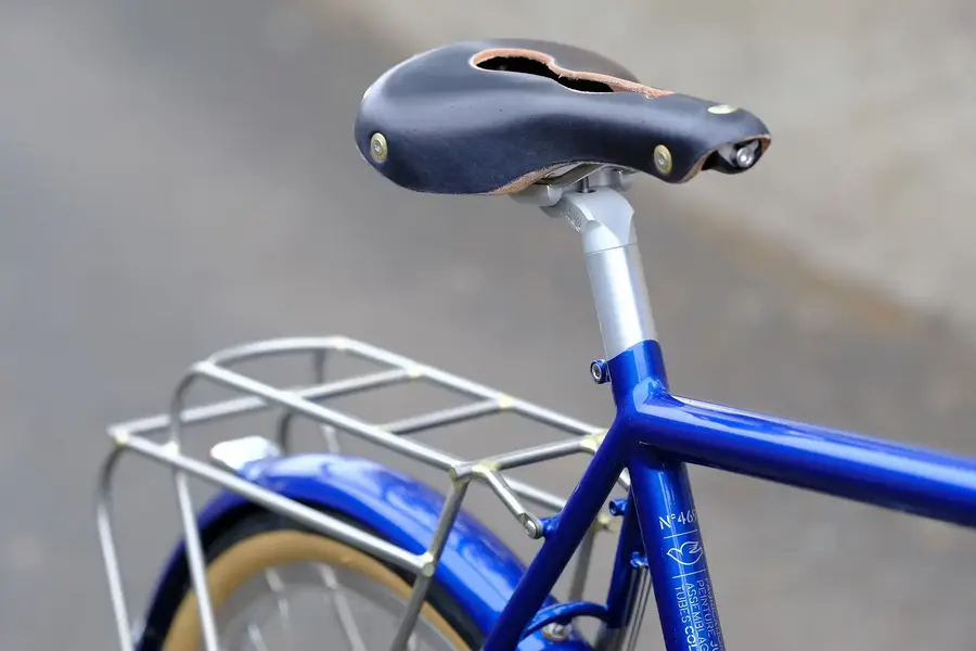

Vintage hikers often featured a detail that can prove to be of crucial help on a trip or long outing: the spare spoke holder. In addition to its practicality, this accessory allows us to make a nod to the history of the artisanal hiker.
Brass does not allow welding with stainless steel. We therefore use money to make the cords (??) for our frames, luggage racks and bottle holders in stainless steel.

As often as possible, we want to offer reliable, durable parts with a limited carbon impact. This hiker was therefore made with many components of European origin: the SON front dynamo hub, the Rohloff rear hub as well as the Gebla box which allows the use of indexed cocottes (Google says cooking pot or early 20th century prostitute, you choose:p GIGFY) with the rear hub, in particular.
