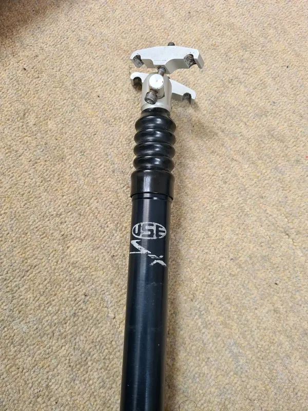

S Shaznaz786 Kona Fan Aug 7, 2021 #1 Hi there All, I'm missing that long piece of metal to anchor seat.. commonly lost.. Anyone have one? I'll put a pic of the shokpost up. All the best.

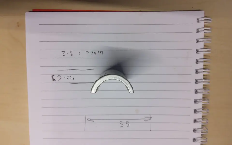

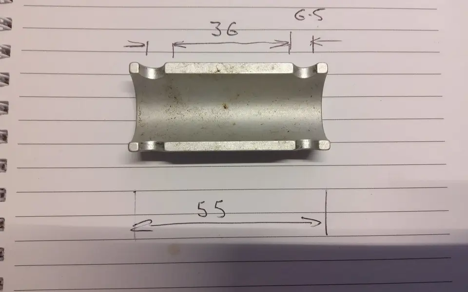

mdvineng Senior Retro Guru Feedback View Aug 7, 2021 #2 Just a section cut out of a tube is the missing piece.
mdvineng Senior Retro Guru Feedback View Aug 7, 2021 #4 Attachments 20210807_123120(0).webp 53.7 KB · Views: 2
S Shaznaz786 Kona Fan Aug 7, 2021 #5 Thanks once again for taking the time, to give the measurements. Much appreciated mdvineng. Kind Regards. Shaz

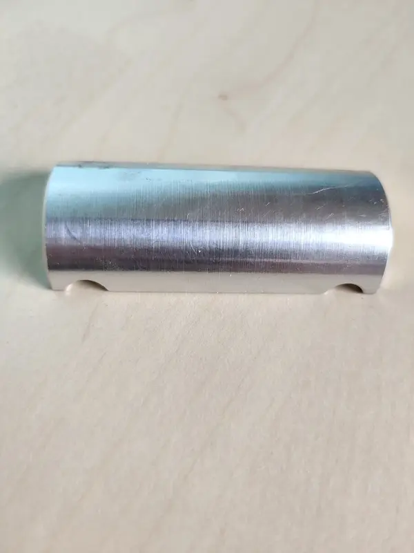

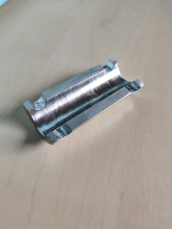

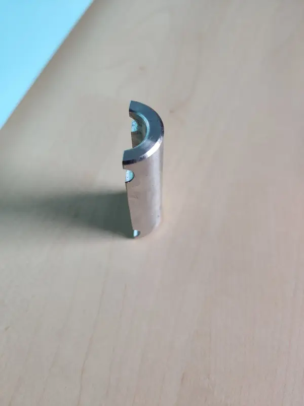

mdvineng Senior Retro Guru Feedback View Aug 8, 2021 #6 Just made this from 7010 alloy, I made the wall thickness greater for increased strength.
S Shaznaz786 Kona Fan Aug 8, 2021 #7 Hi there, Send it to me. Saves me having to do it. What's the price? Shaz
