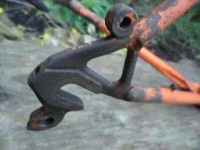

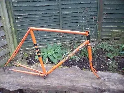

This frame I just bought is said to be a 531 Carlton from the 1970's but it has the earlier Capella lugs. Capella lugs were used by Carlton from 1959-1967.
Down tube transfer and brazed gear lever bosses indicate from the 70's. Dropouts look 70's. Lamp bracket on fork looks 50s-60's. Bit of a weird one 🤔. Did they just use older lugs? (I've seen some mid-late 1970's SBDU Raleigh's use Capella lugs... Even on 753 tubesets; https://raleigh-sb4059.com/2020/02/...bdu-ilkeston-reynolds-753-sb1625-new-arrival/).

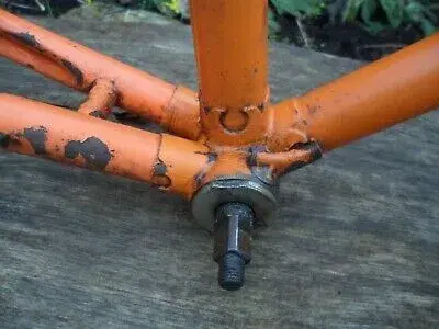

Is that an early Stronglight cotterless axle with the threads on the axle end? I had a couple MANY years ago when I were nobbutt' a lad - and I reckon they were a few years old then!
Or is it some modern 'budget' axle?
Certainly Capella lugs, dropouts look like they have been replaced so could have had more braze ons. I'll have a ponder....
The rear dropouts are by Vitus and appeared on Raleigh & Carlton models in the early 80's so maybe an indication to when the frame was updated.
