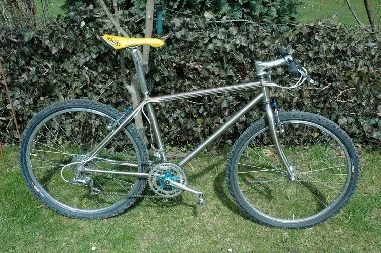

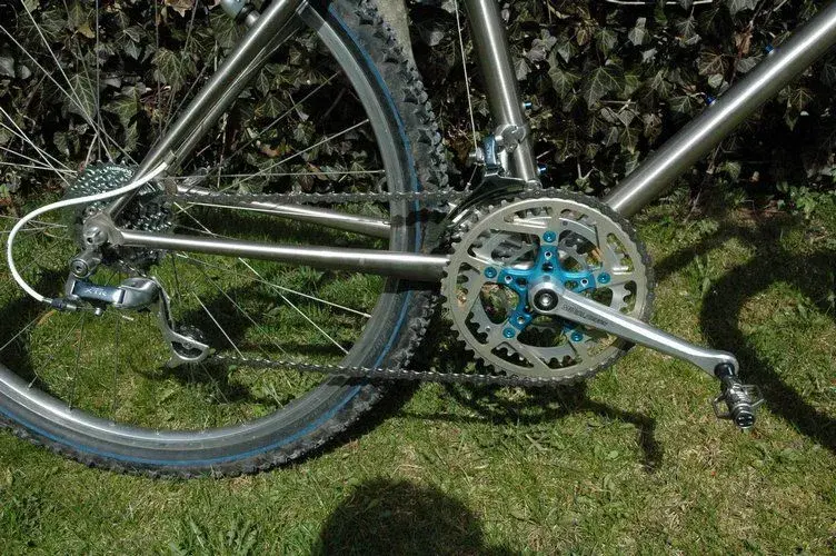

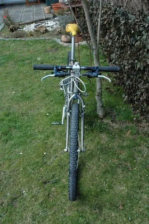

Frame has now been built up...
Looks lovely, not overly keen on white cabling, but it's your bike not mine so i'll just stfu!
I think others are far better qualified than me to guess but I did have a saracen with the noodle cable guide, forward facing seat clamp and ovalised top tube where it met the seat tube. Was a 94 too. High end Saracen?
I say Wheeler, I see a very similar ti-plate finish one all the time and visually yours rings a bell for it...I will look closer next time I walk past it.
