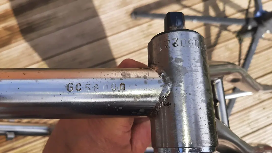

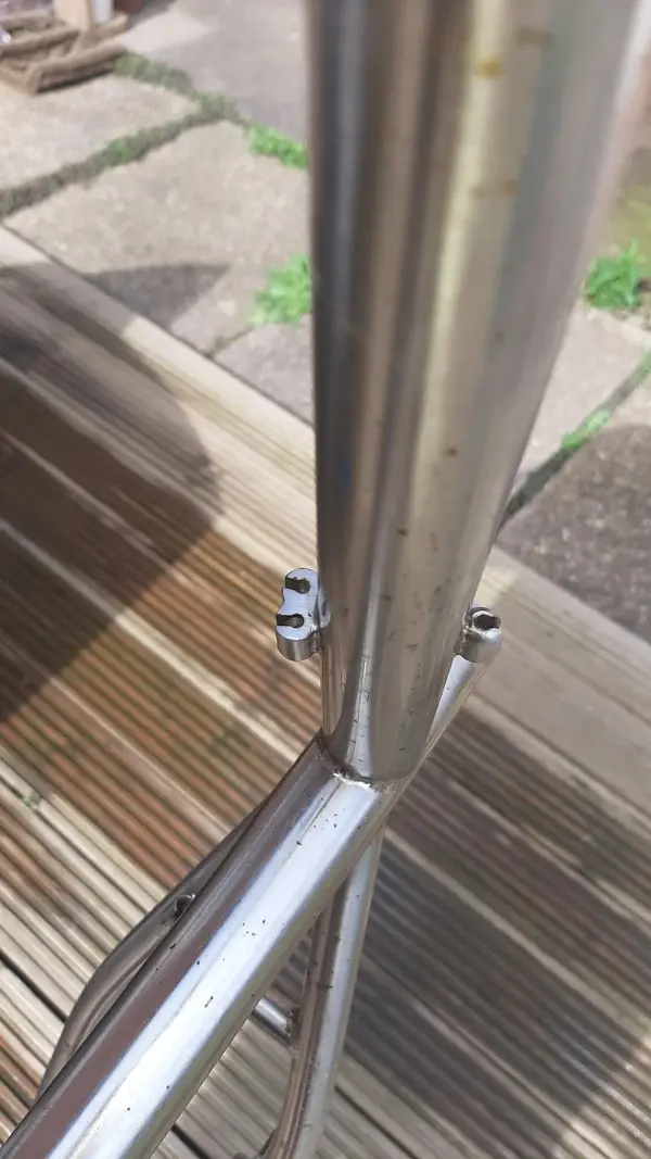

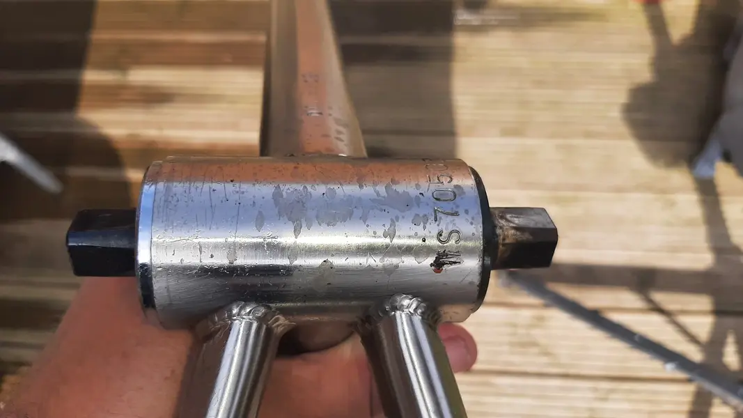

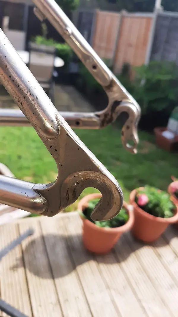

It looks like a copy of a 1994 DiamondBack Axis, similar finish, same cable routing - but wrong frame number, wrong type of steel and no cantilever stop - so it's 1997 or later.
The frame number is most likely WS7050221 - unsure what that other number is. The first '7' in the frame number would assume a 1997 but the WS is unknown at this point.
Thanks for the indo Sam. I hadn't thought about the cantilever stop so will have to go the V brake route and leave the cantis for the MS Racing Comp XT frameset I have to refurbish.

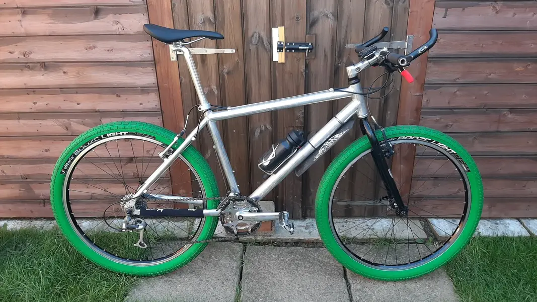

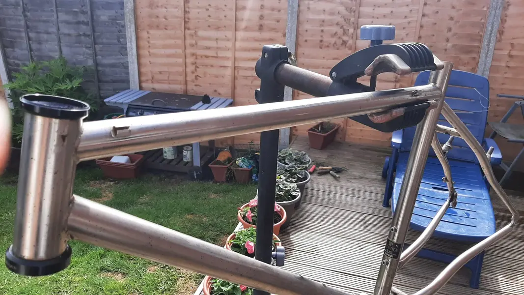

With the last piece now on (matching XT front derailleur) it is now finished. Am pleased with how it turned out and it rides well.
