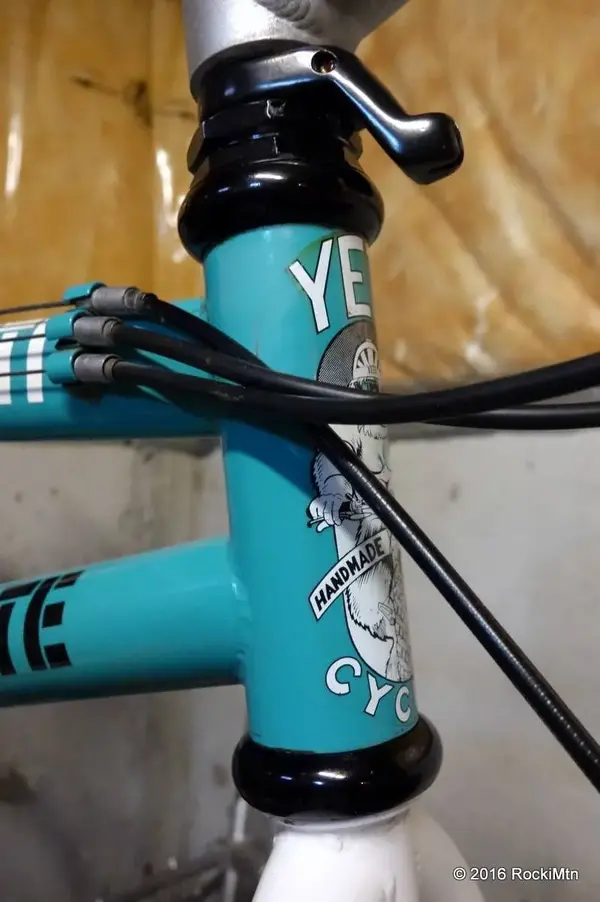

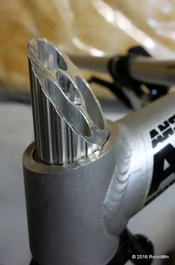

i was hoping to get some riding in after work today, but the sun and heat is just too much in an urban concrete/asphalt setting. we've had on and off again heat waves for the past few weeks. i should have went out yesterday when it wasn't nearly as hot. so instead i decided to lurk in my basement where it's cool and shaded to do some wrenching.
removed the brown YST headset and mounted the CK no logo in it's place. wanted to also install a weight reduced quill wedge in place of the solid piece one, but found that the wedge takes a fine thread bolt, and the existing Tioga branded bolt is course threaded. :?

yes, eventually i'd like to do that, but finding one is the issue. most quill bolts are course threaded. i'm not sure who offers the fine thread ones except for the Zicral ones used on Sycnros stems. i'm assuming this wedge is a Syncros one, which would make sense. i guess i can pillage a bolt off a spare stem for now and bide my time sourcing a replacement.

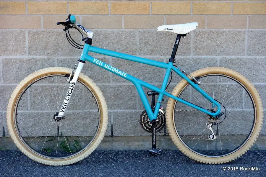

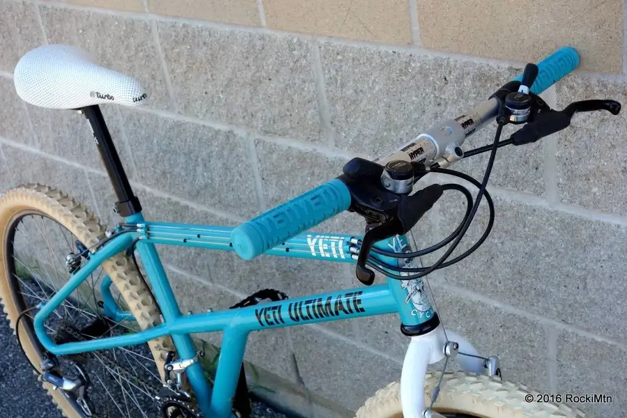

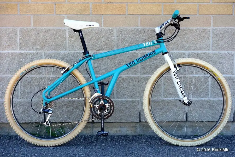

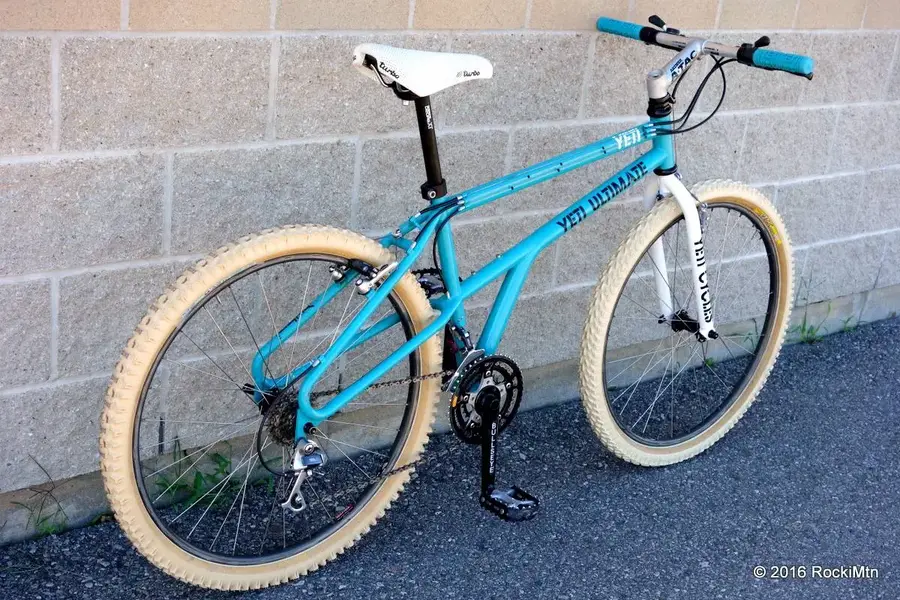

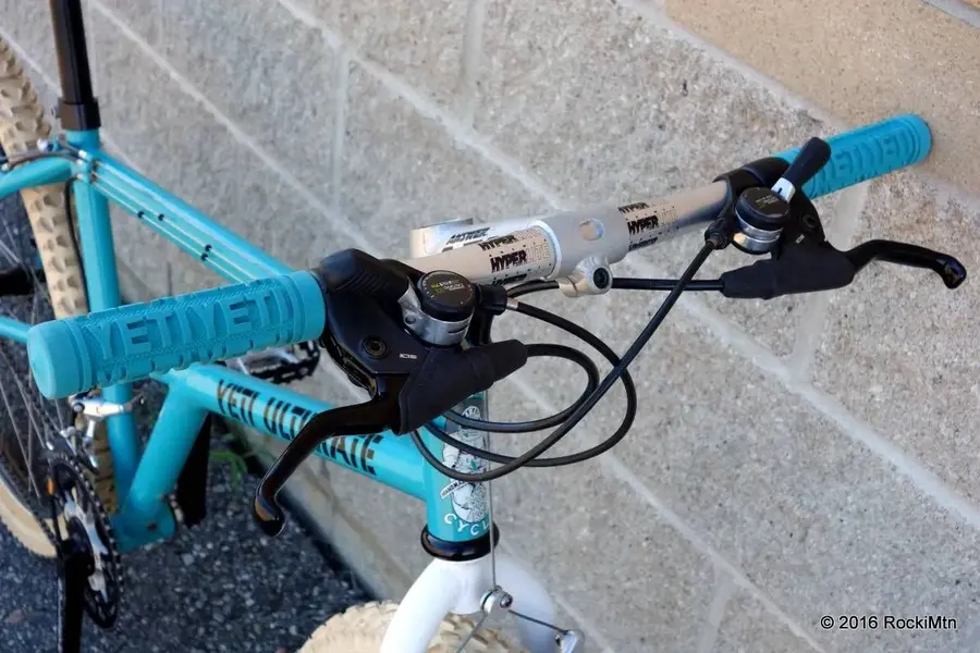

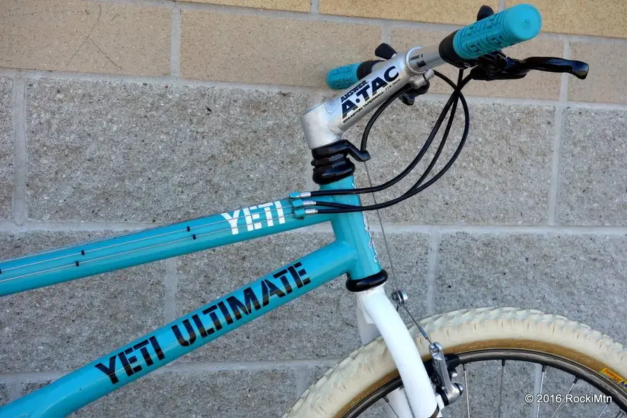

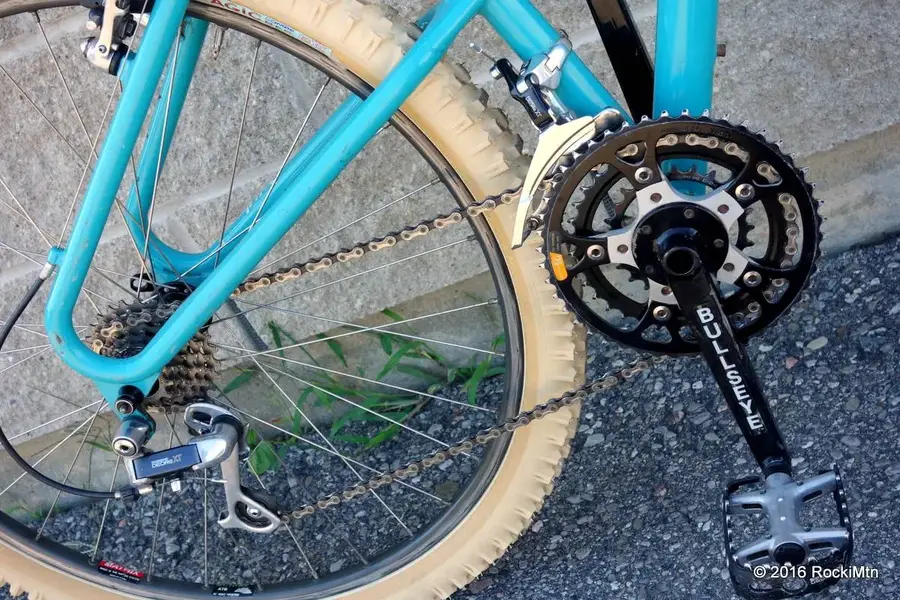

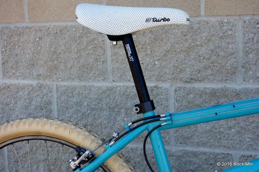

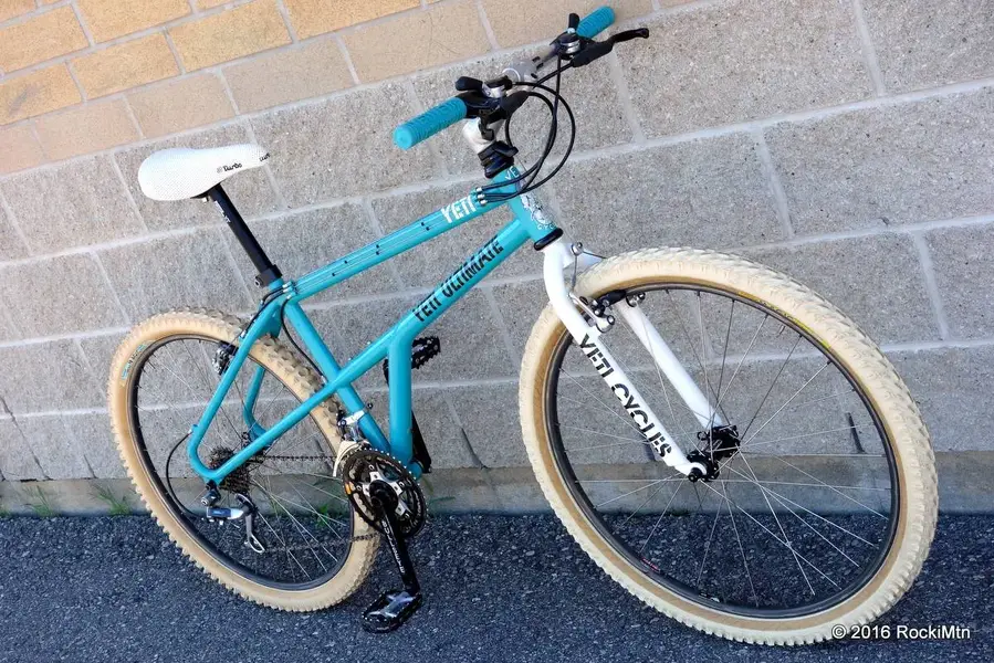

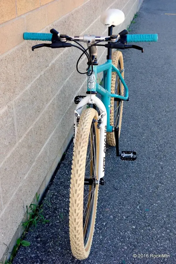

Haven't had much spare time given current circumstances the past couple month. But had the evening yest so I dedicated it to finishing up the remake on the Ultimate so I can finally have a chance of riding it.

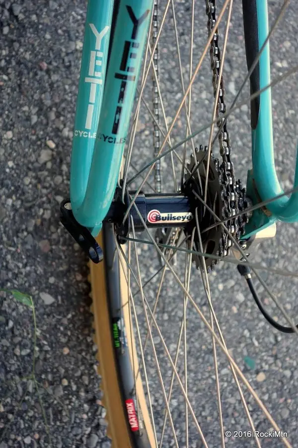

Bike came with both tyres being front ones. Luck would have it, a very good friend had a NOS rear magic tyre that he graciously was willing to offer to me!!! Very happy with that. Rear wheel is relatively dished to the centre now, though not quite. Will need to bring it in to a shop to have it fine tuned as spoke tension seems off and I'm not experienced enough to address it properly. Rear hub also will probably need to serviced with the bearing cartridges replaced as it runs quite noisy/rough sounding. Finished off the wheelset with a pair of Ringle Twist-Cam lever. Tried to do the same with the seat collar, but I can't seem to get the lever to easily apply enough force to the collar clamp. :? So I stuck to the original bolt configuration.

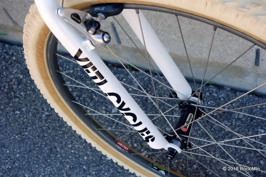

Scored a nice used CK no logo headset. Put on a black middle Shimano to replace the odd silver one to match the inner/outer rings, and mounted correctly as they weren't positioned in the proper rotation on the crank spyder. :? XT bear traps for pedals, replacing a set of Crupi Square BMX style pedals with Ti spindles. Probably will sell the Crupi to make back some money.
NOS XT seatpost and brake levers, though I managed to scuff the one lever already when I didn't set the thumb shifter properly in place to the levers and the thumb arm scraped a nice scratch onto the lever body when I was heavy handed in testing the shifting on the rear. :roll: It's relatively hidden between the lever and thumb shifter so I'm not too upset. I wasn't in search of NOS parts, but it just ended up with a few. There's plenty of patina on the bike anyway but I did take a sharpie to it so it wasn't as noticeable.
Lastly, used set XT canti brakes, older thick XT cable outer/inners, and very PRICEY set of Yeti Speed grips. :shock:
