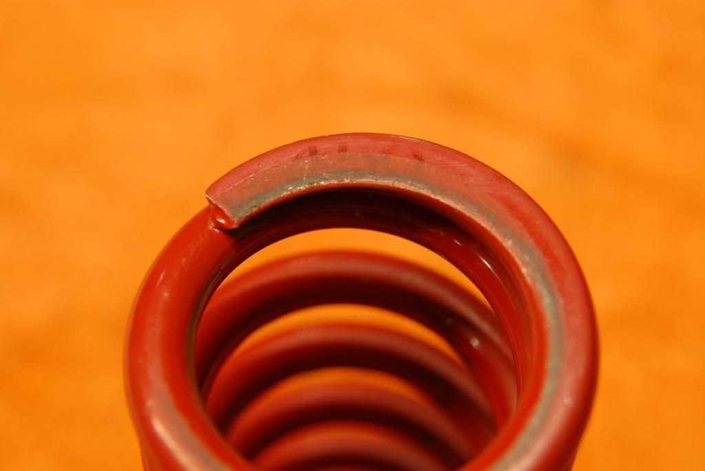

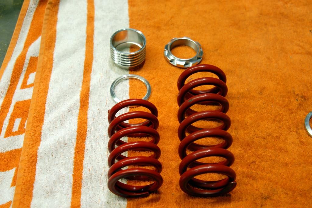

Indeed, the stash included a longer steel spring, and it was a 450. Bingo! You can just about make out the felt pen markings:-

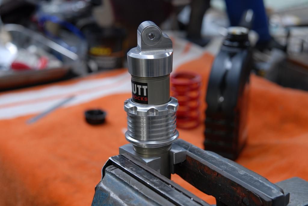

You can see here clearly the tool I made to hold the shock body firmly when unscrewing the top clevis or seal head:-

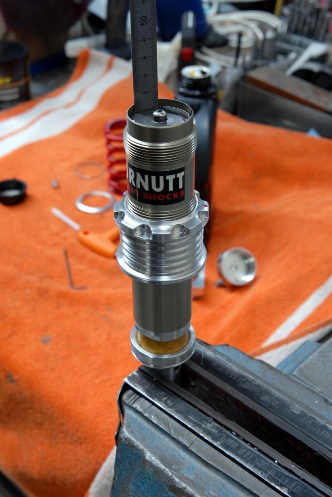

I have also set the air gap at 5mm with the shock compressed:-

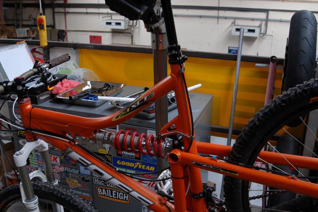

Here you can see the difference in the lengths of the springs. I had to separate the preload spacer from the preload nut to allow it to fit. I love the way these shocks seem to be modular, the top spring perch is identical to the bottom one.

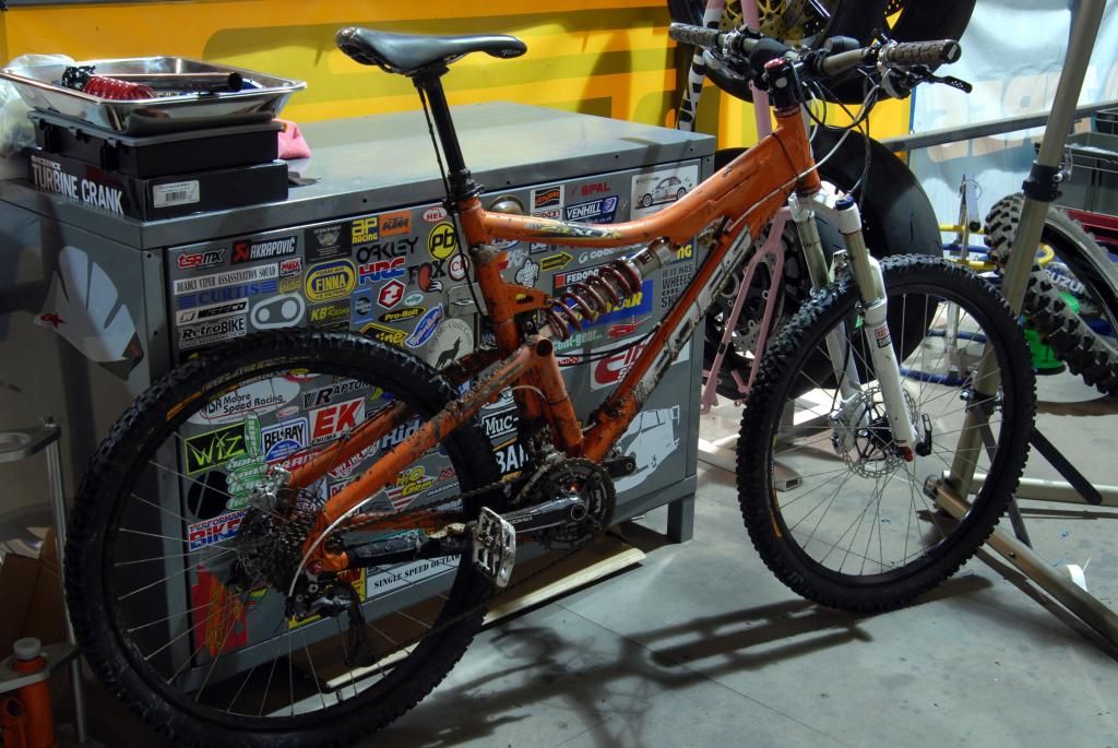

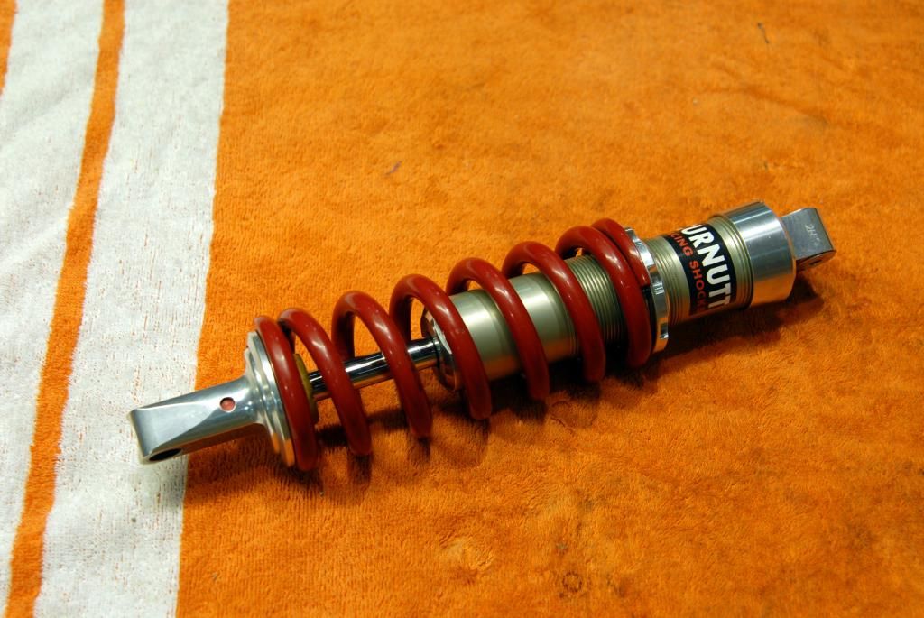

And assembled:-
I have ridden the bike home this evening, and it feels so much better with the heavier spring. I could just get the sag correct with the first spring with four turns of preload, but it is correct with just two turns now, but feels so different. I suspect part of this is down to the reduced air gap, so next time i will try a larger gap, maybe 15mm, to feel what effect that has. My friend had a spin around his driveway to get feel for the bike, he reckoned that the rebound was too fast, I thought it was too slow! This confirms I have the correct weight oil in, the 2.5wt was a guess based on the condition of the oil taken out. I have it set now at one and a half turns out, and is a setting we both agree on.
And assembled:-
